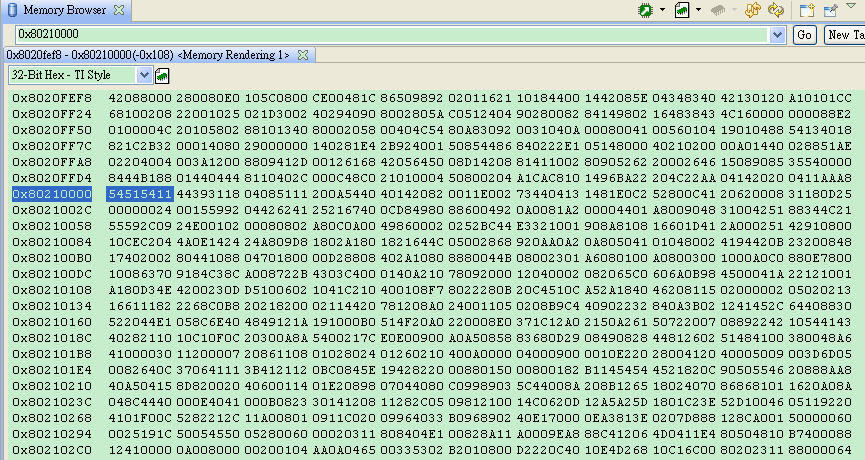

While running EtherCAT app in ICE, connect over JTAG to Cortex-A8 and open memory window.
Open loation 0x4a332480 (PRU-ICSS MDIO user access0 register). Refer to AM335x TRM, 14.5.10.11 MDIOUSERACCESS0 Register for more details
Write 0x80A1_0000 to read Auto-Negotiation Link Partner Ability Register (ANLPAR) (BASE Page), address 0x0005
Can you please report LSW (16-bit) from the same register after writing. This reports the register contents of the PHY.

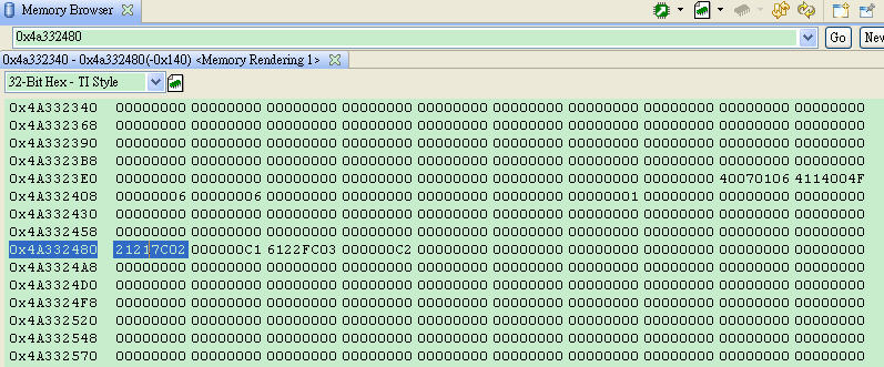

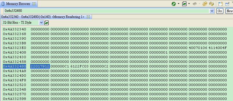

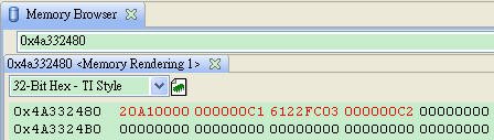

Can you please attach the entire memory window from 0x4a332400 onwards. I assume CU1128 is connected to Port0 when you did above write operation. Correct?

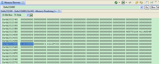

MDIO does not see a link. Link partner register of PHY shows all zeros. Is this possible for you to try with a cross cable? Is this ICE v1 or ICE v2 ?
Can you also check following registers please
0x8021_0000 (BMSR)
0x8121_0000 (SWSCR1)
0x8161_0000 (SWSCR3)
0x8201_0000 (PHYSTS)
You need to write the above values to 0x4a332480 to read from PHY and read back value at 0x4a332480 as first time.

Hi Louis,
Please follow the below mentioned steps

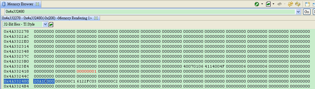

1) Read the PHY CONTROL REGISTER(offset 0x19).
Write the value 0x83210000 to the register 0x4a332480. The last 16 bits will give you the PHY CONTROL REGISTER value. (8021 in my case).
2) Change the 14th and 15th bit to 0 (0021) and write back to PHY CONTROL REGISTER
Write 0xc3210021,in my case to register 0x4a332480
3) Check the link is coming up or not. If not Keep the 15th bit to 0 and change 14th bit to 1(4021) and write back to PHY CONTROL REGISTER
Write 0xc3214021,in my case to register 0x4a332480
Check if link comes up
Prajith
Hi Prajith,
I have try that.
The procedure is run the ethercat_slave.out and suspend the program, and then run the three steps, but it seems can not link with the junction.

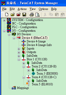

But I find a situation as following:
After run system Initialization, run ethercat_slave.out not yet.
The junction can link to the IN port of ICE board as following the Term 3 is ICE board:
But there may has a bug with Beckhoff junction because port 6.7.8 of junction can not link with the ICE at above situation, only port 2.3.4.5 can be link when system Initialization.
After run the ethercat_slave.out, It unlink soon.
