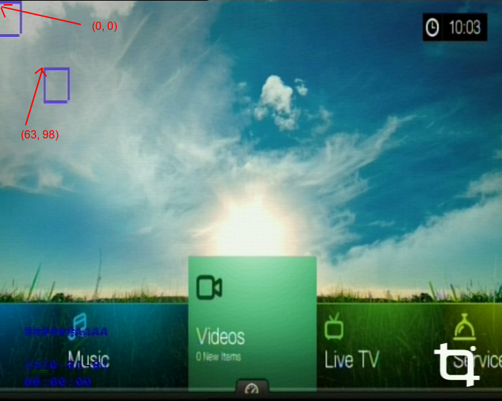

Am using DM8148 for our product development and we are using DVRRDK_03.50.00.05
I was trying to draw rectangle on screen using graphics api's like
int grpx_fb_draw_box(int width,
                     int height,
                     int startX,
                     int startY);
my parameters were as below,
grpx_fb_draw_box(60, 60, 0, 0);
grpx_fb_draw_box(60, 60, 120, 120);
with the above function call, I was expecting one rectangle at (0, 0) location and other one at (120, 120) location. Instead am getting these rectangles at wrong locations, I have attached the snapshot for the further understanding.
P.S: Am working on 720x576 video resolution.
I tried by changing GRPX_PLANE_GRID_WIDTH and GRPX_PLANE_GRID_HEIGHT parameter, but no use.
and also attached graphic.c and graphic.h
