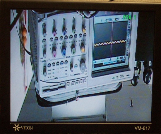

  • Hi Anshuman,
    Thank you for your reply. We did get the video on the display to work correctly. We made the followin changes for VPBE as suggested by you.
    width   = 720;
    height  = 480;
    OSD_VIDWIN0OFST =0x1000 | 1280>>4;
    By doing these changes we were able to get the video to display on the monitor clearly but with a grey bar at the top of the video. Please see the attached picture for referrence. Also could you explain why do you use 0x1000 for OSD_VIDWIN0OFST.We understand V0L0 bit filed is 16 bits/pixel but we do not know why V0AH is set to 0x1000.
    To rectify the grey bar problem, we changed the VPFE  ISIF_MODESET  register to 0x1000 making HD polarity negative. (Which was positive before)
    This eliminated the grey bar and gave us proper video as seen below. We had HD polarity set to positive to avoid clock offset but looks like it had to be negative. Can explain why.

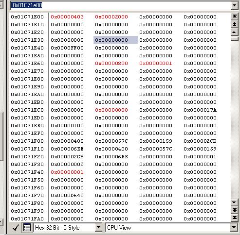

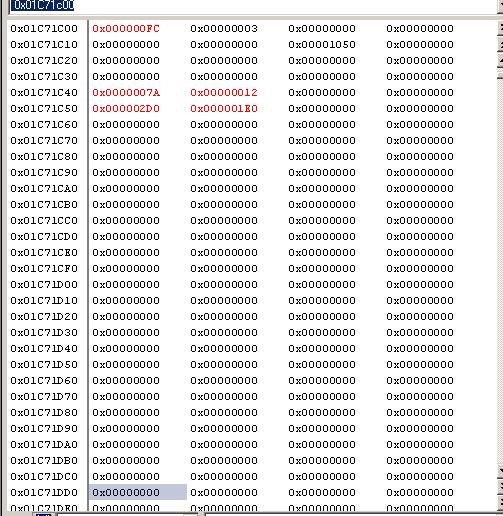

    >> Can you share the register dump of OSD module and the VENC module in your test? There are some upsamplers in OSD module but there is no direct downsampling mode from 1280x720 to 720x480.
    Below is the register dump for the OSD registers.
     Below is the dump for VENC registers.

  • Hi Padmini,
    >>> I dont think it is needed to set 0x1000. Do you see that without setting 0x1000, you get bad output on display?
    >>We see a bad display if we dont use 0x1000. Please see the attached video for the reference.
    I checked and figured out that there is a documentation problem in the VPBE Programmers Guide. It mentions that address in OSD registers has to be set as offset from SDRAM base address. But actually, the case is that the address is the absolute physical address of SDRAM and not the offset. Ofcourse, the setting in register has to be in units of 32 bytes, which means the actual physical address right shifted by 5 need to be set in those registers.
    The address looks as below:
    32 bit address when shifted by 5 becomes 27 bit address.
    Bit 26:23 are in V0AH of VIDWIN0OFST
    Bit 22:16 are in V0AH in VIDWINADH
    Bit 15:0 are in VIDWIN0ADL
    Now assume you had your OSD input data at SDRAM start location, which is 0x80000000. When converted into units of 32 bytes, it becomes 0x80000000 >> 5 which is 0x04000000. this shows bit 26 is set to 1.
    For this reason we had to do an OR ( | ) with 0x1000 in VIDWIN0OFST register.
    >>> HD Polarity issue
    For the hD polarity issue, i am not sure if i can get the right reason. If it was VD polarity, i can explain that there can be a shift in the data downwards because, the data latching starts as soon as the VD signal or HD signal polarity is matched. But for hD polarity case, my explaination does not hold good. Also, you are not seeing a shift in data but a grey bar coming on top of your expected data. Can you explain where do you capture this YUV data? Is it after iSIF or after Resizer module?
    >>> Output of 720x480 and input of 1280x720 issue
    For this issue, i looked at your registers. I can see that your input data is 1280x720 but the actual frame size that you are using is 720x480 set in vIDWIN0XL and VIDWIN0YL. This means OSD hardware is reading the data such that the line offset is 1280x2 bytes and frame size is 720 lines, but it considers the active frame as 720x480 only. Are you sure you are getting the full field of view that you expect? I am thinking you are getting only 720x480 from your full frame size of 1280x720, from the top left corner. One way to check is changing the VIDWIN0XP and vIDWIN0YP registers.
