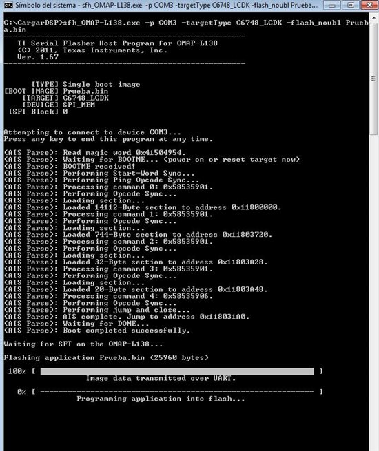

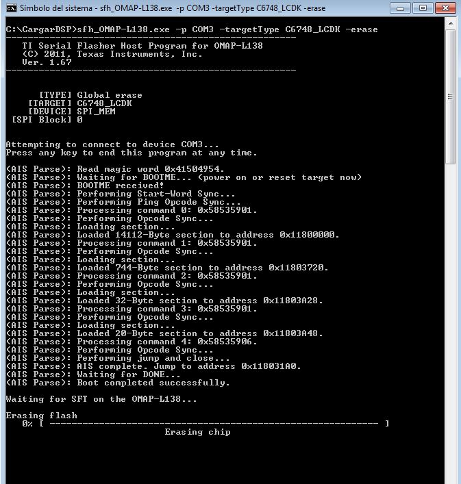

  • When I try to erase the flash, the screen shows: Erasing flash 0%, and the number does not change.
    I put:   sfh_OMAP-L138.exe -erase -targetType C6748_LCDK -p COM3
    When I try to load the program, I put: sfs_OMAP-L138.exe -flash_noubl NameProyect.bin -p COM3
    And the screen in hang out with: Wait for SFT on the OMAP-L138.
    Any idea??
    Kind Regards
    Thank you

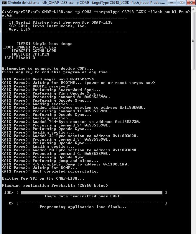

  • Yes, I am using LCDK C6748 board.
    The SW1 switches are:
    1-off   2-on  3-off  4-on 5-off  6-off  7-off  8-off
    And when I try to load a program this is the screen.
    I created the .bin file with the tools "out2rprc".
    Thank you
    King Regards
  • Hi Javi,
    From your screen shot, you didn't mention flash type as NAND.
    You have to mention about flash device what you are using because C6748/OMAPL138 LCDK board had support only for NAND flash and not for SPI flash.
    If you didn't mention then you would get "SPI" default as memory.
    Now use the following commands.
    sfh_OMAPL138.sfh -flashType NAND -targetType C6748_LCDK -erase -p COM3
    sfh_OMAPL138.sfh -flashType NAND -targetType C6748_LCDK -flash_noubl LED.ais -p COM3
