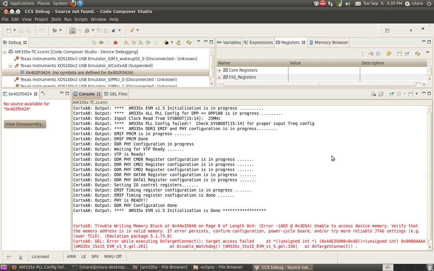

Dear all
I follow this page, try to do SPL debug, and then my CCS shows the following error message
CortxA8: Output: ****  AM335x EVM v1.5 Initialization is in progress ..........
CortxA8: Output: ****  AM335x ALL PLL Config for OPP == OPP100 is in progress .........
CortxA8: Output: Input Clock Read from SYSBOOT[15:14]:  25MHz
CortxA8: Output: ****  AM335x PLL Config failed!!  Check SYSBOOT[15:14] for proper input freq config
CortxA8: Output: ****  AM335x DDR3 EMIF and PHY configuration is in progress.........
CortxA8: Output: EMIF PRCM is in progress .......
CortxA8: Output: EMIF PRCM Done
CortxA8: Output: DDR PHY Configuration in progress
CortxA8: Output: Waiting for VTP Ready .......
CortxA8: Output: VTP is Ready!
CortxA8: Output: DDR PHY CMD0 Register configuration is in progress .......
CortxA8: Output: DDR PHY CMD1 Register configuration is in progress .......
CortxA8: Output: DDR PHY CMD2 Register configuration is in progress .......
CortxA8: Output: DDR PHY DATA0 Register configuration is in progress .......
CortxA8: Output: DDR PHY DATA1 Register configuration is in progress .......
CortxA8: Output: Setting IO control registers.......
CortxA8: Output: EMIF Timing register configuration is in progress .......
CortxA8: Output: EMIF Timing register configuration is done .......
CortxA8: Output: PHY is READY!!
CortxA8: Output: DDR PHY Configuration done
CortxA8: Output: ****  AM335x EVM v1.5 Initialization is Done ******************
CortxA8: Trouble Writing Memory Block at 0x44e35048 on Page 0 of Length 0x4: (Error -1065 @ 0x3D5A) Unable to access device memory. Verify that the memory address is in valid memory. If error persists, confirm configuration, power-cycle board, and/or try more reliable JTAG settings (e.g. lower TCLK). (Emulation package 5.1.73.0)
CortxA8: GEL: Error while executing OnTargetConnect(): target access failed     at *((unsigned int *) (0x44E35000+0x48))=(unsigned int) 0x0000AAAA [AM335x_15x15_EVM_v1_5.gel:261]     at Disable_Watchdog() [AM335x_15x15_EVM_v1_5.gel:336]     at OnTargetConnect() .
Can anyone tell me how to solve this issue? Thanks :-)
My environment are:
Board: Customized board
Chip: XAM3359AZCZ
DDR: DDR2, Micron MT47H32M16HR-3
Oscillator: 25Mhz
JTAG: XDS100 V2
SDK: t-isdk-am335x-evm-06.00.00.00-Linux-x86
GEL File: AM335x 15x15 EVM v1 5
