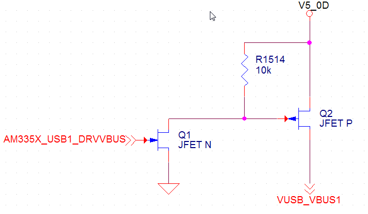

Hi.
I'm working on a custom board built around an AM3352 processor. This board is closed to the sitara EVM SK demoboard, but with less features.
One new feature, thus, is an USB module using a TI CC2531 chip, built on the same board as the AM3352, and connected to it using USB1_DP and USB1_DM connections.
Unfortunatly, this module is not detected by the AM3352.
lsusb command returns :
Bus 001 Device 001: ID 1d6b:0002 Linux Foundation 2.0 root hub
Bus 002 Device 001: ID 1d6b:0002 Linux Foundation 2.0 root hub
cat /proc/driver/musb_hdrc.1 command returns :
Status: MHDRC, Mode=Host (Power=e0, DevCtl=91)
OTG state: a_idle; inactive
Options: pio, otg (peripheral+host), [eps=16]
Peripheral address: 00
Root port status: 00000100
dmesg | grep usb gives lines included in the attached file.
The board includes a 1k5 pull up resistor on the D+ line.
The module should communicate through cdc_acm driver interface, but ls /dev/ttyA* returns nothing.
Note : A demo version of our board including only the CC2531 part (same schematic for this part) is correctly detected (/dev/ttyACM0 found) when connected to the USB1 port of an AM335x_evm SK sitara kit.
The linux system on our board is quite similar compared to the one present on the sitara kit.
When the D+ line is shorten to GND, following messages are displayed :
[  349.345733] ti81xx_interrupt 1118: CAUTION: musb1: Babble Interrupt Occured
[  349.353759] musb_stage0_irq 817: unhandled DISCONNECT transition (a_idle)
[  349.360870] musb_stage0_irq 817: unhandled DISCONNECT transition (a_idle)
[  349.368133] musb_babble_workaround 921: Babble: devtcl(90)Restarting musb....
But nothing is displayed when the short is removed, as if the AM3352 didn't detect the rising edge on D+
I don't understand what happens and I'm looking for new tracks to explore...
Thank you all for your future help.
  • Hi Didier,
    Please post the schematic connections of the USB both on the AM335X side and the device side.

    I just read in the AM335x datasheet (chap. 16.3.7) that both USBx_ID and USBx_VBUS pins are importants for that detection phase.
    I watched our schematic and detected that our connections here are not as expected :
    USB1_VBUS is connected directly to 3.3V
    USB1_ID is not connected at all
    As I understood in the datasheet, the processeur senses USB1_VBUS to see if a voltage greater than 4.4v is present. If no, the controller doesn't start listenning to new connection on the bus. Do you confirm ?
    If true, is there any other solutions ?
    I saw some comments about the DEVCTL[SESSION] bit in the datasheet, that says that this bit can be used to tell the controller to start operating as a host. Could it be used to override this kind of hardware problem, at least, to check that the problem has been found ?
  • Hi Didier,
    I see that you are looking in the right direction. For Host mode operation the USB needs:
    USB_ID to be tied to GND.
    USB_VBUS should be tied to the VBUS power supply after a power switch, that's controlled by USB_DRVVBUS.
    Since in your case both devices are on-board you can replace the power switch with a simple transistor circuit, similar to this:

  • Didier,
    To workaround the USB1_ID pin issue in your design, you can use the following patch.
    diff --git a/drivers/usb/musb/ti81xx.c b/drivers/usb/musb/ti81xx.c
    index 74288a8..fcee071 100644
    --- a/drivers/usb/musb/ti81xx.c
    +++ b/drivers/usb/musb/ti81xx.c
    @@ -1244,7 +1244,6 @@ int ti81xx_musb_set_mode(struct musb *musb, u8 musb_mode)
                    regval = musb_readl(reg_base, USB_MODE_REG);
                    regval &= ~USBMODE_USBID_HIGH;
    -               if (usbid_sw_ctrl && cpu_is_ti816x())
                            regval |= USBMODE_USBID_MUXSEL;
                    musb_writel(reg_base, USB_MODE_REG, regval);
    There is no way to workaround that USB1_VBUS tying to 3.3V. You either have to add the power switch as Biser recommended, or tie USB1_VBUS to 5.0V and use the following patch if you use SDK6.0 kernel 3.2. But please change 'id == 0' to 'id == 1' in the patch.
    http://e2e.ti.com/support/arm/sitara_arm/f/791/p/333490/1163908.aspx#1163908
  • Thank you Bin and Biser for all your answers.
    The situation is clear : We can't avoid a board redesign.
    Thank you again
