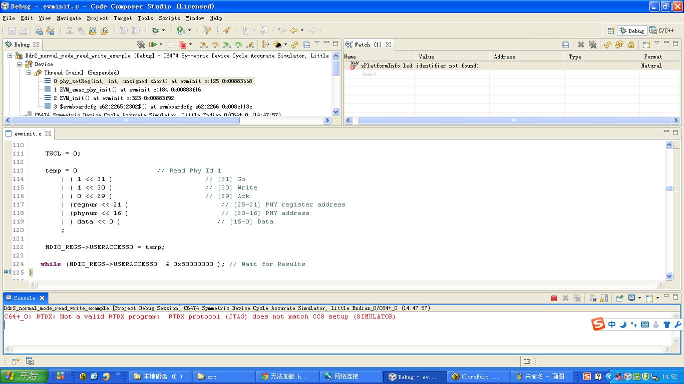

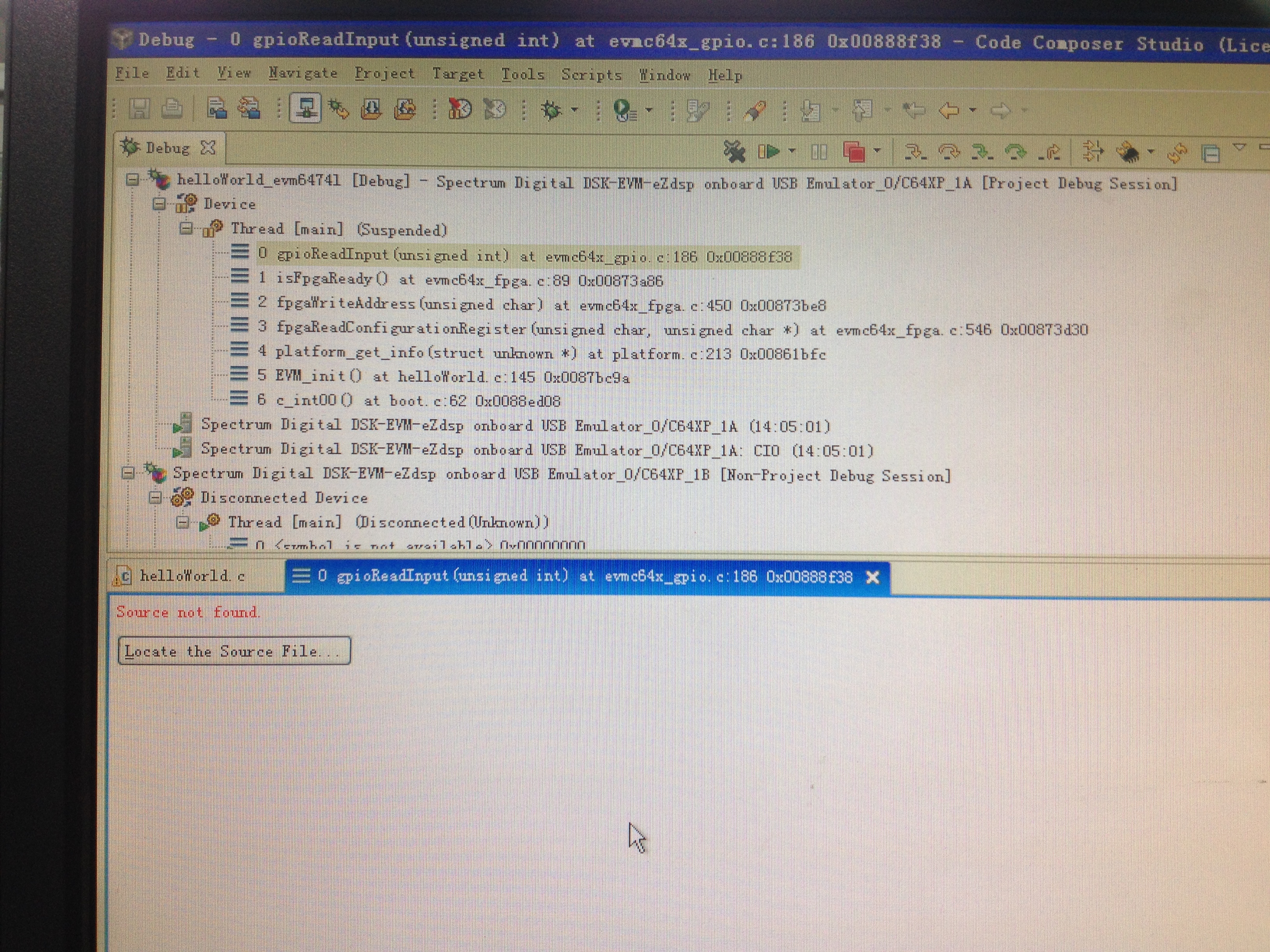

  •     the error project when runs it has no response, after click the halt button, it appears as the picture show.
    while the OK project does not appears that problem. It puzzles me, please help.

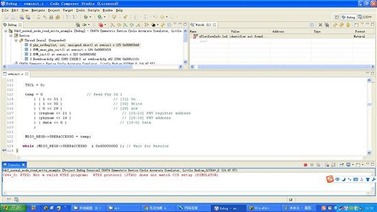

  • Hi,Pubesh
          I download the .out file into the dual_evm6474 board and run it .  The picture shows the error status.
    I try to build the project , but the .tcf file can not import , the console message as follows:
