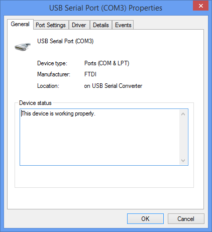

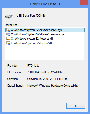

    Windows installed the USB Serial driver itself. I did not do it manually. Device manager shows a USB serial port COM3.
    For the record, here is the snapshot of the driver details window.
    Teraterm does not seem to get any response (for any switch settings).
