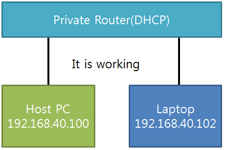

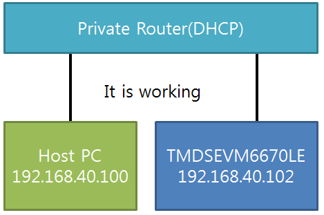

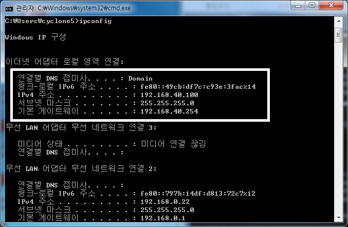

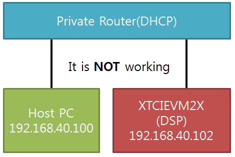

My board is working but not pretty good.

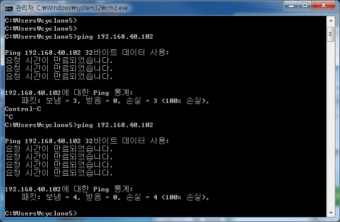

sometimes board works well, sometimes board doesn't receive IP address from DHCP server.
board interface is not link up, I think
I can't find different point both of situations.

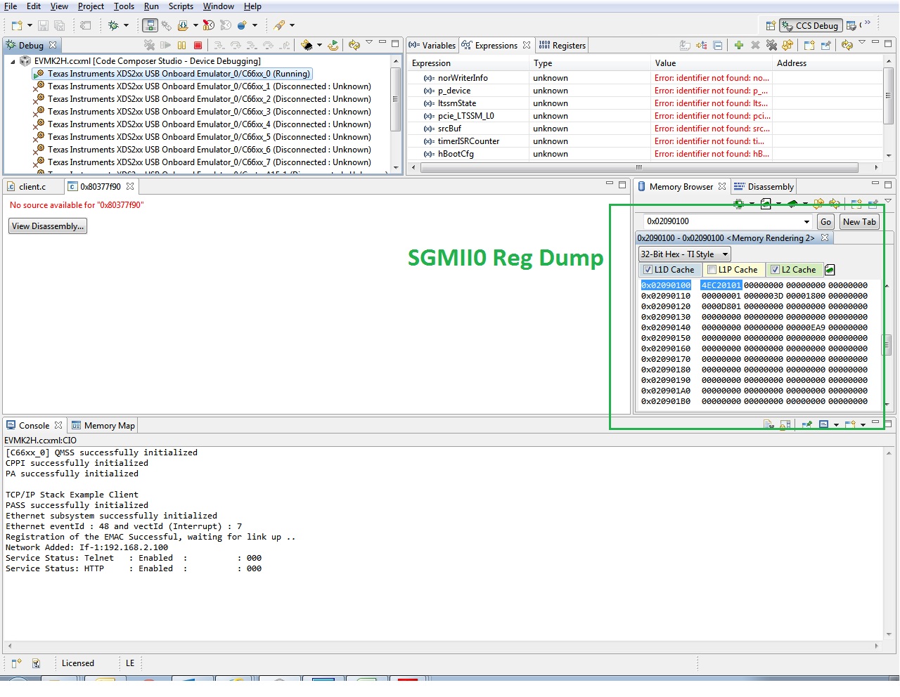

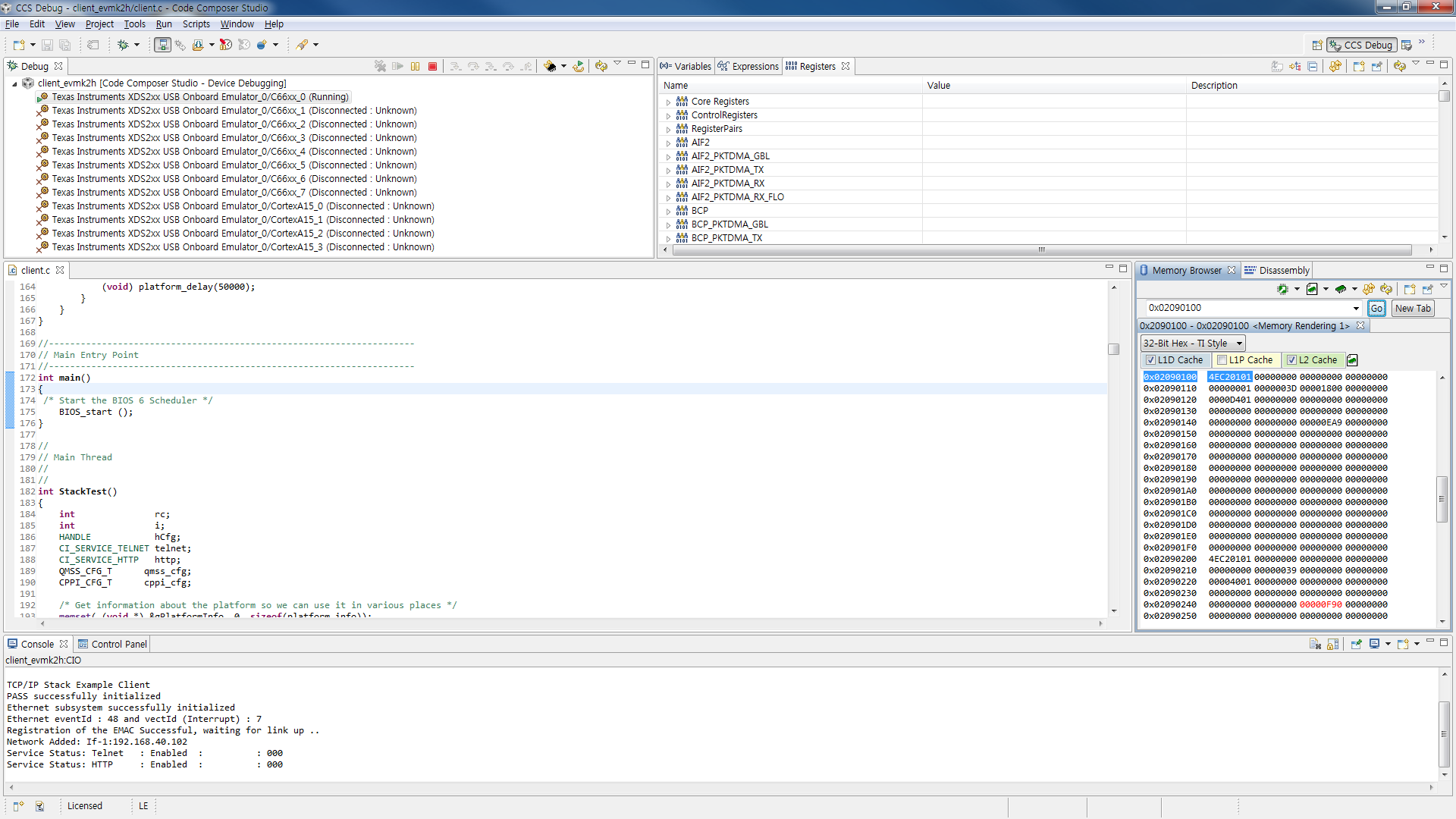

This is a message in not working status.
TCP/IP Stack Example Client
PASS successfully initialized
Ethernet subsystem successfully initialized
Ethernet eventId : 48 and vectId (Interrupt) : 7
Registration of the EMAC Successful, waiting for link up ..
Network Added: If-1:192.168.40.102
Service Status: Telnet : Enabled : : 000
Service Status: HTTP : Enabled : : 000
QMSS successfully initialized
CPPI successfully initialized
PA successfully initialized

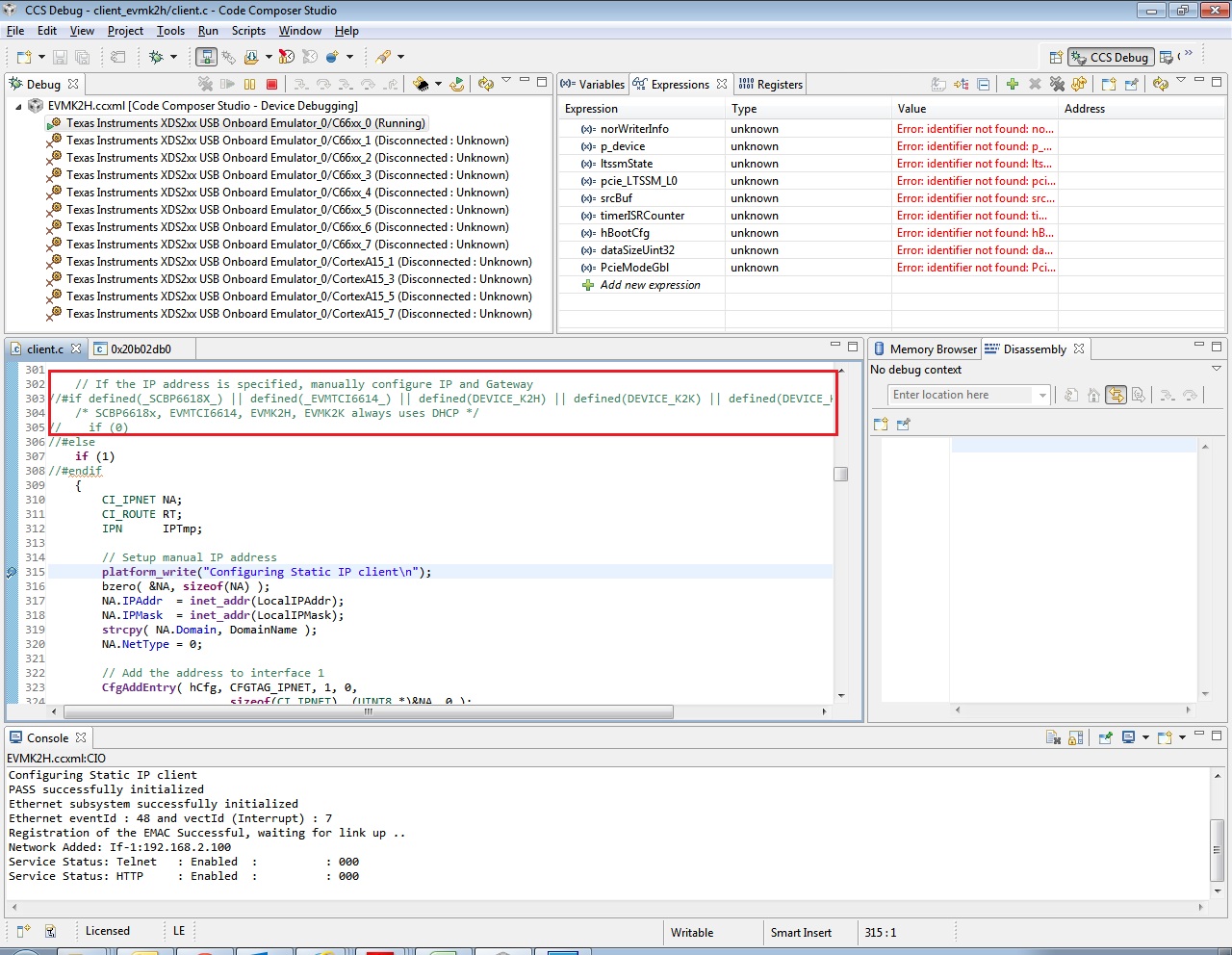

and I have another question.
can I use static IP address??
My system have no DHCP server. and board will use static IP address only.
