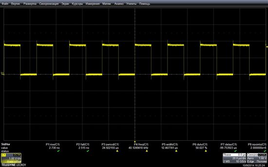

To test the configuration and DEVOSC stability, I setup DEVOSC output to clkout1 and I see 20MHz as should be.
Acording to documentation RTCDIVIDER is fixed.
The frequency I see with oscilloscope when rcosc32 is set to output is about 39kHz..
Can somebody tell me how this could be?

  • Hi, Pavel.
    Now I understand about RTCDIVIDER, thank you.
    As I said I tried other clocks and I saw them, so I don't think my configuration is wrong.
    But I checked this:
    CM_CLKOUT_CTRL:
    ./mem_rdwr.out --rd 48180100
    [host] 0x48180100:
    [host] 0000008A
    CLKOUT_MUX:
    ./mem_rdwr.out --rd 481C52E4
    [host] 0x481c52e4:
    [host] 000A0000
    Anyway I see 38.7 kHz..

    You can measure the 24.5xx MHz with the scope, but 32.768KHz is much smaller value (than 24.5xx MHz) and you are very close to that value (32.768KHz -> 38.7KHz). I suspect your scope is not configured properly for such small values (KHz).
    Pavel
  • Hi Pavel.
    I am measuring frequency with digital oscillosope. I am pretty sure that freq measurement is correct.
    And we have RTC onboard that can output 32768 Hz. And I can measure RTC Square wave output very fine -> 32768 Hz.

  • Hi Pavel!
    Finally I get DM385 IPNC to check rcosc_23k_ck on it.
    I configured both clkout: clkout0 and clkout1 to output 32k.
    All I can say - I still see 40kHz!
    So it is already on 2 boards - our custom board and IPNC..
