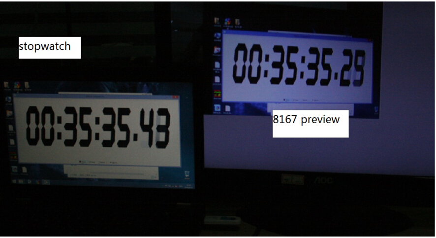

Hello:
        our product need more real time stream
        link chain: capture->swms->display
        delay test method: camera focus on a stopwatch,then take a photo,the preview will delay than the sotpwatch
       e2e now not support upload image?
    stream input is 720P50,only use 1 channel(support 4channel)
    my usecase code:

  Iwant to reduce the capture delay. maybe you can give me some advice to debug this issue!
