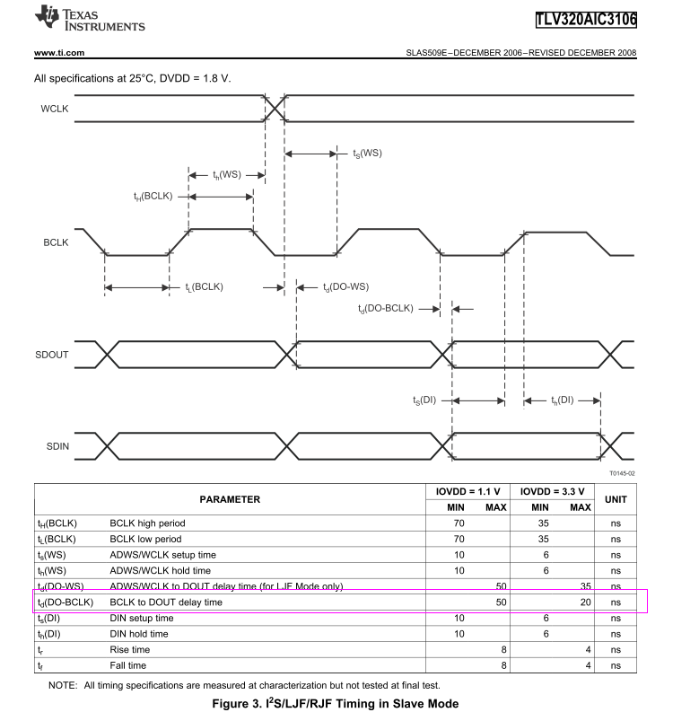

Hi,everyone
SDK6.0, Platform AM335x, Audio IC tlv320aic3106
Td(DO-BCLK) BCLK to DOUT delay time out of spec(measure 362ns spec<20ns)
Other Parts Discussed in Thread: TLV320AIC3106
Hi,everyone
Hi Ryan,
Which specification are you referring to and how do you measure this? And what is your question?
HI Birse,
Discuss with your detailed FAE, testing is OK, but there's a new problem:
static struct snd_platform_data am335x_evm_snd_data1 = {
.tx_dma_offset = 0x46400000, /* McASP1 */
.rx_dma_offset = 0x46400000,
.op_mode = DAVINCI_MCASP_IIS_MODE,
Set Mode IIS mode, but the feeling is DSP measurement signal, your EVM borad the signal the same way, if you can confirm it?
