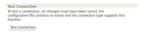

    One more thing I want to confirm is I am using XDS 510 USB, 14 Pin emulator. Can that cause any difference?
    You can test your "target configuration" under CCS. When you select the board/device and the Connection (XDS510USB Emulator) you can test the connection. If the test run successful, then your emulator is fine.

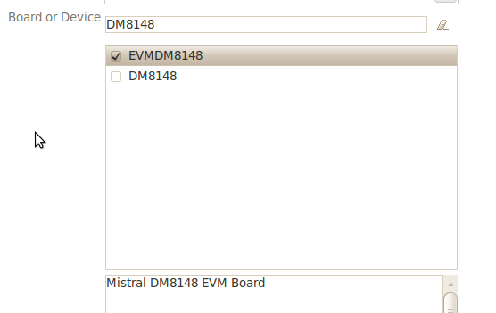

  • Krunal,
    krinali shah said:
    target/board = TI814x(no STM, ETB only)
    Can you try with EVMDM8148 (instead TI814x), does it make any difference?
  • Hi Pavel,
    Thanks for suggestion.
    By selecting EVM DM8148 board, I connected Cortex A8, with TI814x_ddr3.gel file
    After that I configured CPSR.M = 0x13
    Enabled NEON from ARM Advanced Features.
    After that I loaded DDR3_SlaveRatio_ByteWiseSearch_TI814x.out program.
    The program loaded successfully and asks for following details.
