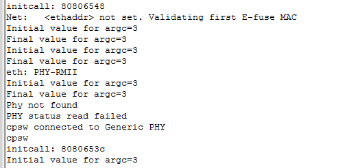

  • Hi Walter,
    I have the same configuration as you on a custom AM3352 + DP83848. I was wondering if you could help me get this up and running with RMII interface.  I have the same code setup as you posted and with the following:
    pinmux:
    static struct module_pin_mux rmii1_pin_mux[] = {
    {OFFSET(mii1_crs), MODE(1) | RXACTIVE}, /* RMII1_CRS */
    {OFFSET(mii1_rxerr), MODE(1) | RXACTIVE}, /* RMII1_RX_ERR */
    {OFFSET(mii1_txen), MODE(1)}, /* RMII1_TX_EN */
    {OFFSET(mii1_rxdv), MODE(1) | RXACTIVE}, /* RMII1_RX_DV */
    {OFFSET(mii1_txd1), MODE(1)}, /* RMII1_TD1 */
    {OFFSET(mii1_txd0), MODE(1)}, /* RMII1_TD0 */
    {OFFSET(mii1_rxd1), MODE(1) | RXACTIVE}, /* RMII1_RD1 */
    {OFFSET(mii1_rxd0), MODE(1) | RXACTIVE}, /* RMII1_RD0 */
    {OFFSET(rmii1_refclk), MODE(0) | RXACTIVE}, /* RMII1_REF_CLK */
    {OFFSET(mdio_data), MODE(0) | RXACTIVE | PULLUP_EN},/* MDIO_DATA */
    {OFFSET(mdio_clk), MODE(0) | PULLUP_EN}, /* MDIO_CLK */
    {-1},
    am335x_emv.h:
    /* Network. */
    #define CONFIG_PHYLIB
    #define CONFIG_PHY_NATSEMI
    #define CONFIG_DRIVER_TI_CPSW
    cpu.h:
    /* gmii_sel register defines */
    #define GMII1_SEL_MII 0x0
    #define GMII1_SEL_RMII 0x1
    #define GMII1_SEL_RGMII 0x2
    #define GMII2_SEL_MII 0x0
    #define GMII2_SEL_RMII 0x4
    #define GMII2_SEL_RGMII 0x8
    #define RGMII1_IDMODE BIT(4)
    #define RGMII2_IDMODE BIT(5)
    #define RMII1_IO_CLK_EN BIT(6)
    #define RMII2_IO_CLK_EN BIT(7)
    #define MII1_IO_CLK_EN 0x1
    #define MII_MODE_ENABLE (GMII1_SEL_MII | GMII2_SEL_MII)
    #define RMII_MODE_ENABLE     (GMII1_SEL_RMII | GMII2_SEL_RMII)
    #define RGMII_MODE_ENABLE (GMII1_SEL_RGMII | GMII2_SEL_RGMII)
    #define RGMII_INT_DELAY (RGMII1_IDMODE | RGMII2_IDMODE)
    #define RMII_CHIPCKL_ENABLE     (RMII1_IO_CLK_EN | RMII2_IO_CLK_EN)
    I don't know what else is missing but I could not get u-boot to recognize the PHY.
    Any suggestion would be great.
