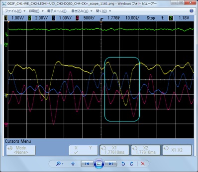

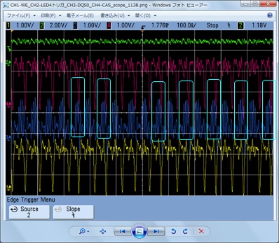

  • Hi Mukul,
    I'm sorry for my late reply and I'd appreciate your advice.
    I've got a wavefrom below measured by one of my customers.  The customer guess it's the b2b writes because the WE signal overlaps with DQS signal that you can see in blue boxes on the waveform.  The customer thinks it corresponds to the seamless burst write operation in the JEDEC standard.
    It seems the insufficient information though I'd like your opinions about the waveform.
    Would you think that it's the b2b writes?  Any comments would be appreciated.
    o Figure 1. Measured Waveform
      Yellow : WE
      Blue   : DQS
      Red    : CAS
    o Figure 2. Enlarged a blue box in the Figure 1
      Yellow : WE
      Blue   : DQS
      Red    : CAS

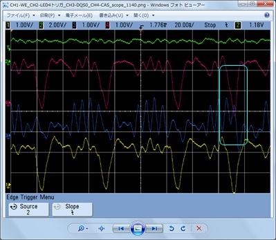

    o Figure 3. Enlarged a blue box in the Figure 1 (with CK instead of CAS)
      Yellow : WE
      Blue   : DQS
      Red    : CK
    j-breeze
  • j-breeze,
    I cannot draw any conclusions from the scope captures.  The signal integrity is marginal either due to the PCB layout or the scope bandwidth.  Can you capture the same problem at a lower DDR data rate to make the timing more clear?  The problem should still exist at lower rates.  What data rate are you running?
    What is the problem being flagged?  Are they concerned because they see WRITE Commands in the same clock as when DQS is toggling?  This is not a problem.  The DDR interface as defined by JEDEC operates with pipelined command cycles.  The data portion of the read or write happens several clocks later.  This is defined as the CL delay.  The DDR controller comprehends the pipelined nature of this interface and continues issuing new commands.  This is normal.  Please see Figure 22 from the DDR2 JEDEC spec which shows a back-to-back write.  You can see that the second write command is coincident with the DATA phases of the first write.  Different CL settings or controller delays could move this to second command to match the scope pictures provided.
