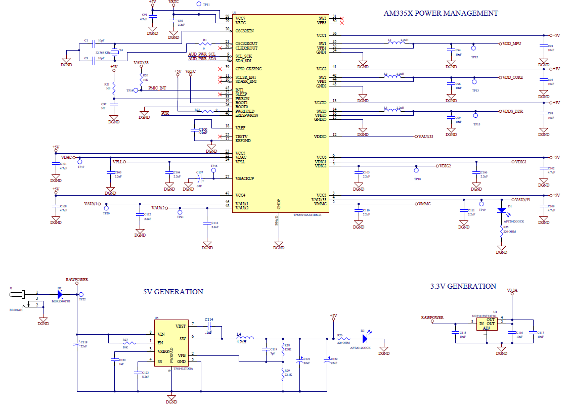

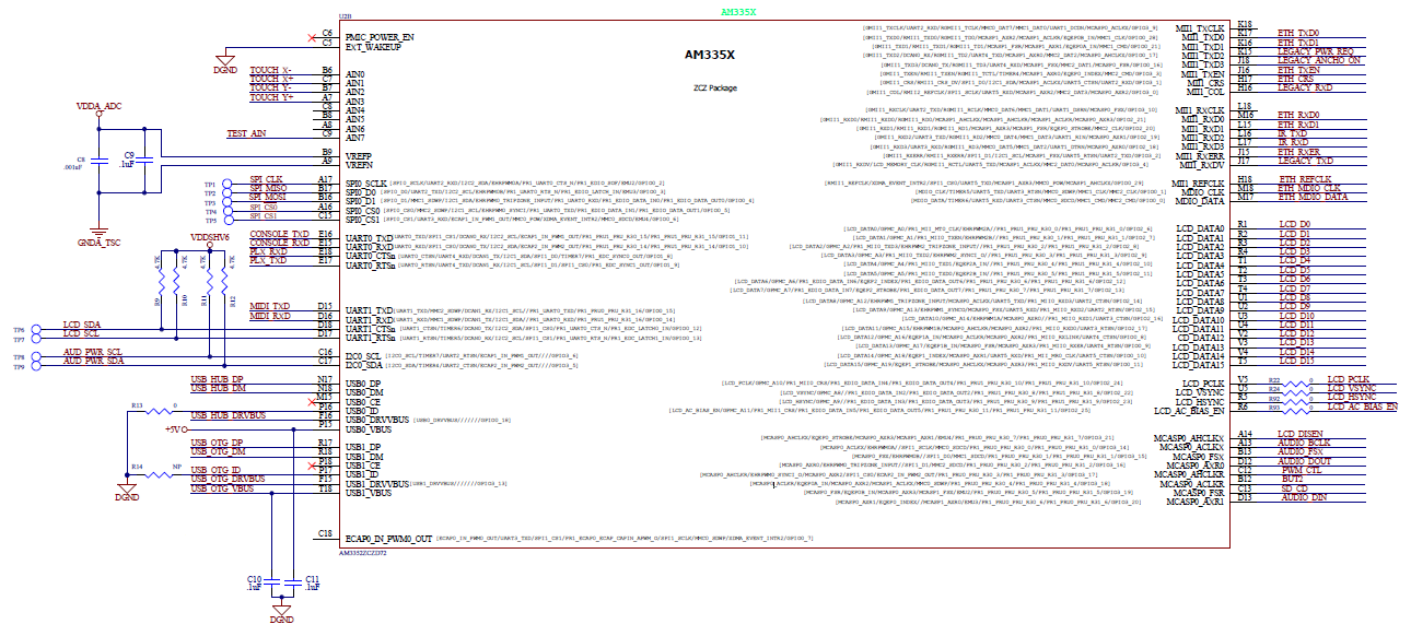

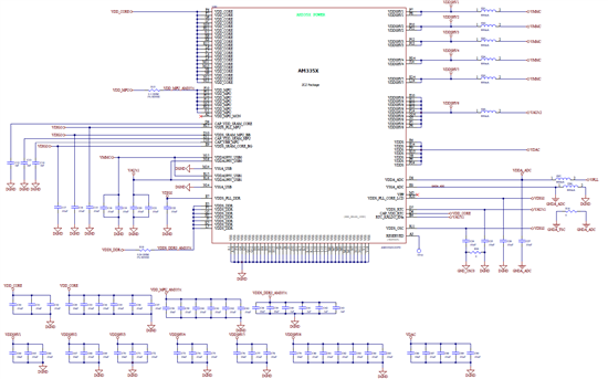

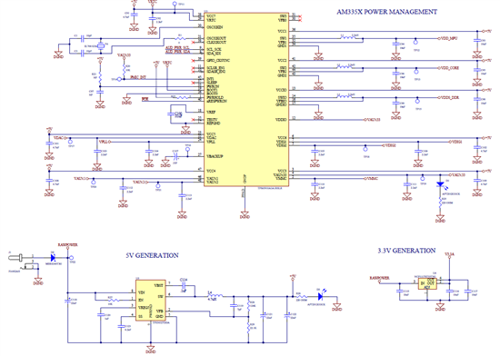

    Here are schematics of my processor and power sections if that is helpful at all.  It follows closely to the starterkit:

  • Hi Jarrod,
    I see that you have serial resistors on the MPU and DDR supplies. These are placed on the reference designs only for current measurement and should not be present on end designs. I suggest you replace those with 0Ohms resistors and remove them completely if you respin the board.
  • Biser,
    Thanks i forgot about those!  Those shouldn't cause the problem I am getting though should they?  I replaced them with 0 Ohm on the boards and still the same issue : (.

  • Forgot to ever post back the solution! I finally did discover the problem. The MPU trace was undersized on our custom PCB, so when we went up to 1GHz and it started processing alot of instructions (in this case uncompressing the kernel) it would cause the MPU power to drop locking up the CPU.
    If you scoped at the PMIC the line was stable, but at the decoupling caps near the CPU you could see the drop. Fattening up this trace fixed the issue and I can now run at 1GHz : ).
