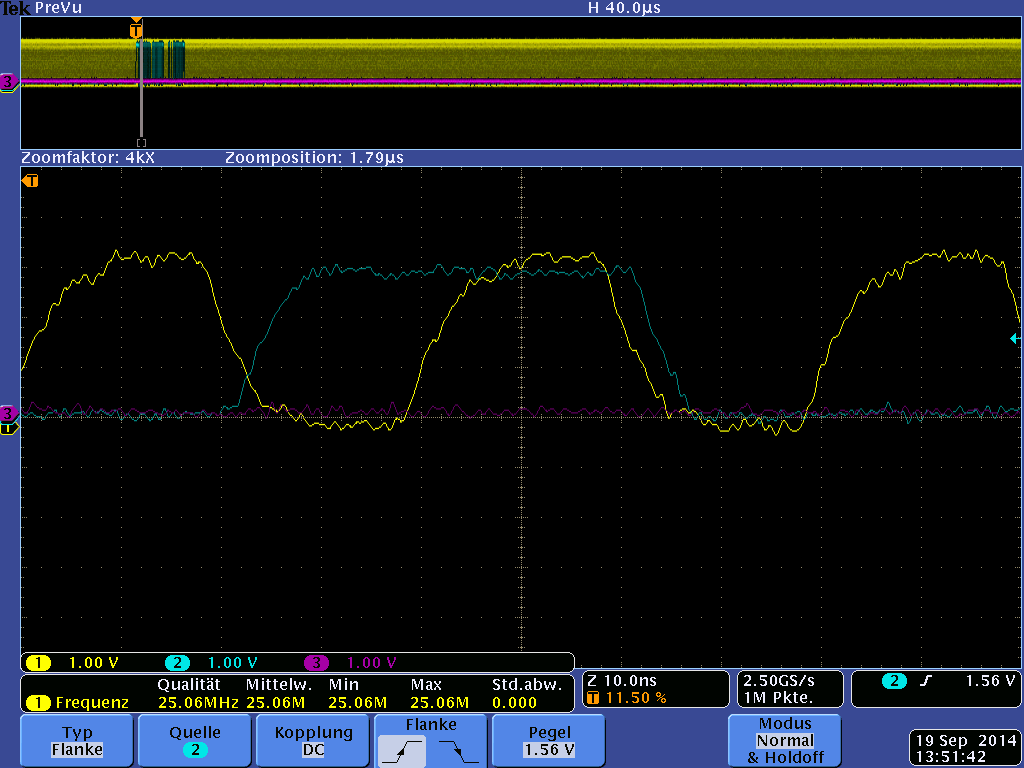

    i already tried a better oscillator, because the one we used before didn't match the requirements of the PHY. Unfortunately with no result...
    Regarding the layout we think, that the signals are looking pretty nice :
    Blue: TX_EN
    Lila: TX_D0
    Yellow: TX_CLK
     don't they?

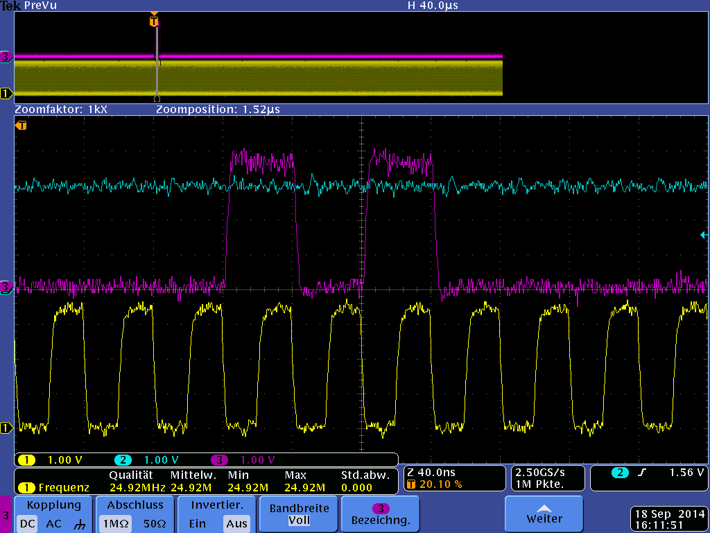

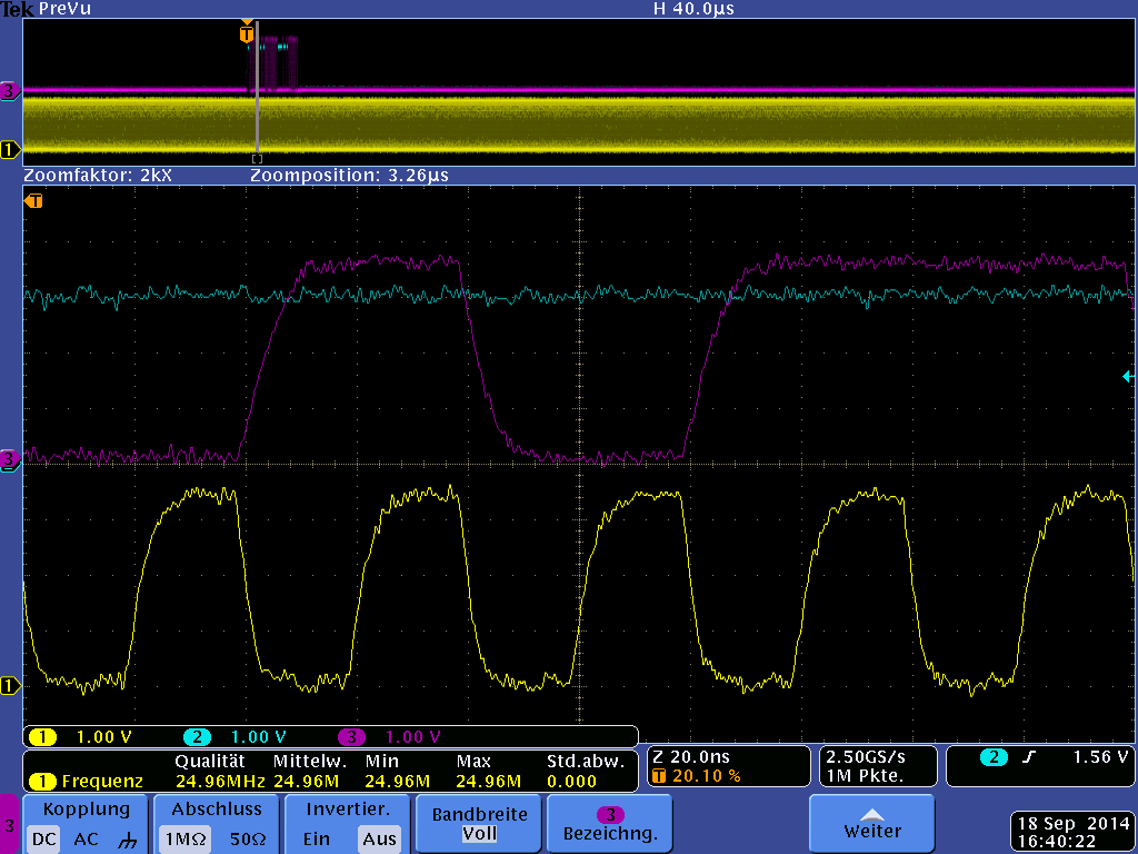

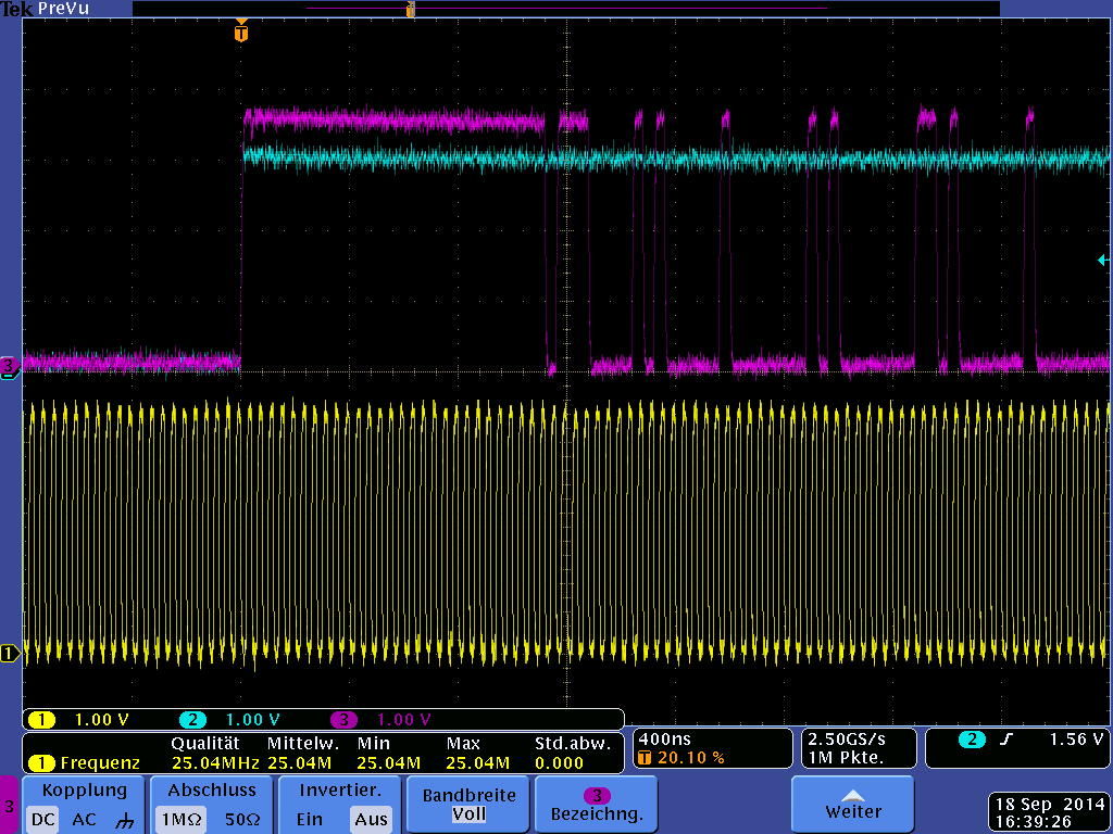

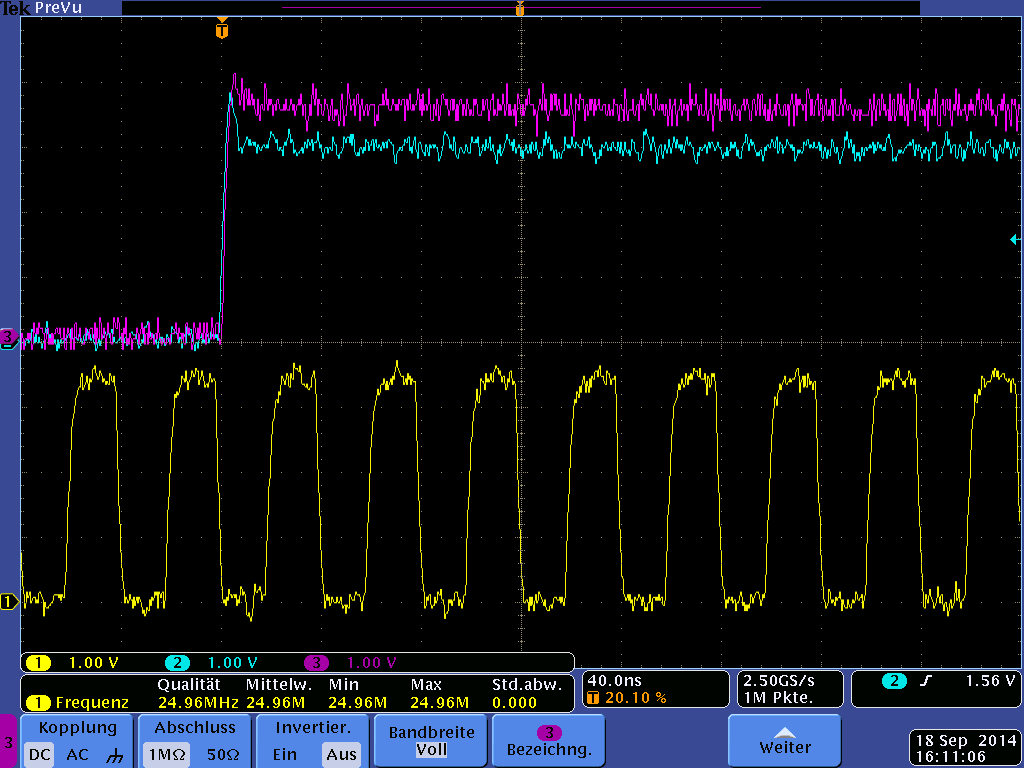

    we also checked our MII signals today, section 7.14.3 of the datasheet specifies the transmission time of data and clock singals with max. 3ns. Our signals are slower:
    yellow = rxclk, blue = rxd0 and magenta is rxd0 after a multiplexer needed to avoid bootstrap conflicts between Sitara and PHY.
    For having a reference, we measured the same signals of the properly working developmentboard and they are looking pretty similar:
    Could this still be an issue? What do you think about the signals?
    The jitter of our clock is within the specification of the datasheet...

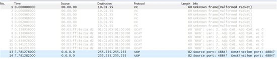

    the signals are measured on port 0...we could see that there is happening something on the rx and tx lines, when the master was trying to connect.
    The wireshark log shows, that there is never coming a response from the sitara side, trying to connect over TwinCAT:

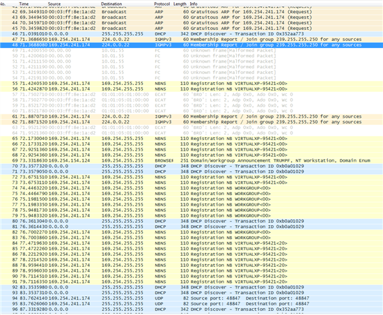

    You mentioned there is TX activity  - can you monitor this by sending a NOP frame for example and see TX frame is correctly sent out using scope or sniffer (like netanalyzer).
    Can you also please connect a working board to Port1 and monitor above registers and error counters (both above setup and working board)
    This is the only thing I can see with Wireshark:
    Sending a NOP frame from the Sitara side? How can I do that?

    With only port 0 connected, I get the same values except for 0x4a32e080. There the value changed to 0xFFFFFFFF
    With port0 connected to the sitara and port1 connected to another slave I got those values:
    *0x4a332000 = 0x41,                *0x4a332004 = 0x59
    *0x4a332010 = 0x480401,        *0x4a332014= 0x480700
    *0x4a332050 = 0x000000,        *0x4a332054 = 0x5
    *0x4a32e080 = 0xFFFFFFFF , *0x4a32e084 = 0x0067035F
    *0x4a320200 = 0x100,              *0x4a320204 = 0x4BD44C
    This indicates that there is activity on Port1 RX - which is not matching your test setup. Definitely nothing is seen by PRU on Port0. It will help to have 0xE00 value as well...
    Can you please power reset the ICE board before doing the subsequent test. This way status flags will be initialized correctly for a fresh run...
    I actually meant to send from PC (instead of using TwinCAT) - this is a bit more controlled setup. For eg:- using colasoft packet player or IXIA
  • Jens Kaufmann1 said:
    Here the registers for the working board:
    only port0 connected:
    *0x4a332408 = 0x7                   *0x4a33240c = 0x2
    *0x4a332050 = 0x0,                  *0x4a332054 = 0x0
    *0x4a32e080 = 0x00BFFFFF ,  *0x4a32e084 = 0xFFFF0000
    *0x4a320200 = 0x100,               *0x4a320204=0x44C
    This really looks good. Is this Phytec board?
    port0 connected to sitara and port1 connected to other ecat slave:
    *0x4a332408 = 0x7                   *0x4a33240c = 0x1
    *0x4a332050 = 0x2,                  *0x4a332054 = 0x2
    *0x4a32e080 = 0x00BEFFFF ,  *0x4a32e084 = 0x0547FFFF
    *0x4a320200 = 0x40100,            *0x4a320204=0x0058C5CC
    To mention is, that the slave on port1 can not be detected by TwinCAT...
    So network is
    TwinCAT -> Sitara+Micrel -> Sitara+Renesas -> Other ESC
    and above configuration for Sitara+Renesas? What is the link polarity settings (enhanced link detection disabled?)  MDIO/Firmware only detected link on Port0 based on above. So it is not surprising that slave on Port1 is not detected
    Did you check Link LEDs?
    Yes these are the registers from the phytec board.
    So network is
    The network was TwinCAT -> Sitara + Micrel (phytecboard) -> Other (working) ESC and the . So there must be an issue with port1 configuration on the phytecboard. (we didn't test port1 before)
    No, the register values are for Sitara+Micrel, port0 connected to TwinCAT and port1 connected to other ESC.
    Link configuration is enhanced link detection enabled and active low polarity for both ports.
    The Link LED on port1 is blinking (2seconds on, 2sec off).
    What could be the reason that the link is getting dropped after 2 seconds?
