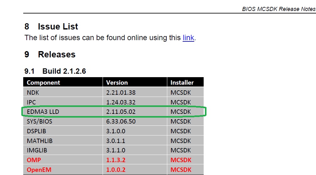

  • Ganz,
    The MCSDK_2_01_02_06 release was built and validated against using the following components:
    Will you check with C:\ti\edma3_lld_02_11_05_02\packages\ti\sdo\edma3\rm?
  • Pubesh,
    EDMA3 v2.11.05.02 has the same problem as v2.11.14.19.
    GanZ
