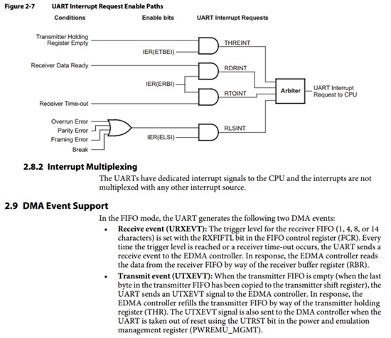

I'm not sure whether this belongs in this forum on the Keystone / C66xx forum, but I'll try here first. I'm trying to implement a simple program that receives data from the UART. I can do this by constantly polling the UART, but I wanted to make the application interrupt based so that the receive task will be more efficient.
I am using the latest version of SYS/BIOS and CCSv6 along with TMDSEVM6670LE.
Here's what I've done so far:
1. I followed the examples I've seen in the forum to configure the CpIntC to call the interrupt service function when system event 165 (UART Receive event, according to the 6670 Data Manual).  Here is the relevant part of the cfg file:
/* Interrupt configuration */
var CpIntc = xdc.useModule('ti.sysbios.family.c66.tci66xx.CpIntc');
CpIntc.sysInts[165].fxn = '&event165Fxn';
CpIntc.sysInts[165].arg = 165;
CpIntc.sysInts[165].hostInt = 2;
CpIntc.sysInts[165].enable = true;
CpIntc.mapHostIntToHwiMeta(2, 4);

When the CpIntc_postSysInit function posts event 165, the interrupt handler fires as expected. The receive task also detects the semaphore has fired once. It appears that everything is wired correctly. The problem is that the UART receive interrupt never appears to fire when text is sent to the serial port.
Has anyone seen this before? Do I need to do something else to enable the UART receive event, or have I misread the manual and chosen the wrong event ID?

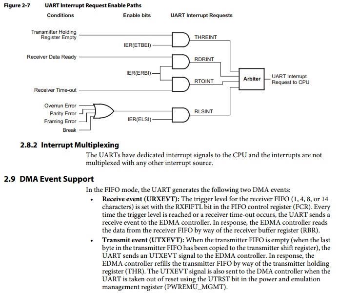

  • It looks like you are using the CPU and not using EDMA to service the UART so you shouldn`t be using EVENT 165.
    Please chnage this to event id 164 which is the multiplexed UART interrupt to CPU as shown in the UART user guide.
    You are currently setting it to EVT ID corresponding to URXEVT which is a recieve EVT to the EDMA controller.
    Hope this helps. Your CpIntC configuration in SYSBIOS appears to be correct so I don`t see any issues there.
    Rahul
  • Rahul,
    Thank you for your help. This fixed my problem.
