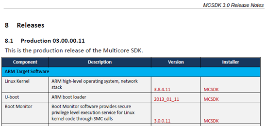

  • Hi Rajasekaran,
    This is the capture of XTCIEVMK2X EVM release note.
    I cannot find the kernel source code in MCSDK intallation directory, it is empty.
    [ethan@porsche ~]$ ll /opt/ti/mcsdk_linux_3_00_00_11/board-support/linux-src/
    total 0
    [ethan@porsche ~]$
    So I download kernel by using "git".
    Following shows many tags of kernel revision, which one I should checkout ?
    I have tried "K2_RT_LINUX_03.08.04_13.11", it has the same Ethernet problem.

    I found the right kernel source and Ethernet TX problem is fixed.
    There are two git repositories:
    1) git://git.ti.com/keystone-linux/linux.git
    2) git://arago-project.org/git/projects/linux-keystone.git
    The 2nd one has the tag "DEV.MCSDK-03.08.04.11" which matches "3.8.4.11" mentioned in the MCSDK release note.
    Which repository should be the offical kernel source for XTCIEVMK2X EVM ?
    Anyway, thanks for your help!
    Ethan
