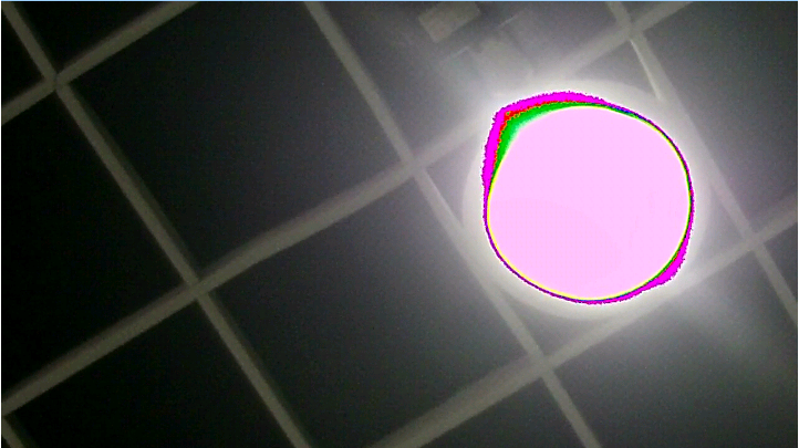

in this picture, the pink circular shoud be a white light. But now it is pink, I don't Know why.

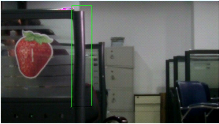

the post in the green rectangle could be straight. But now itis curve.
Our own camera didn't have the filter witch is covered the CMOS chip. Is the filter the reason for distortion?
Or may be there is another reason for this distortion?

    The issue 1 looks to me as a saturation problem. I assume you are using the parallel raw sensor input to DM365. DM365 has a 16 bit input interface and but your sensor may or may not have those number of data output lines. Generally, if the sensor is 12 bit raw data output, it might be connected to lines 15:4 of DM365 and the same is set in the CGAMMAWD register of the ISIF.
    Can you tell me how is the sensor output connection to DM365? Also, whether your sensor is 10,12,14 bit raw data sensor?
    What mode of drivers are you using - i mean, chained mode or non-chained mode? Can you capture the sensor output from ISIF directly into DDR and share the raw data with us? Any sort of image processing is available in IPIPE and by looking at sensor raw output data we can find out how is the input from sensor.
    The issue #2 also looks to me as a sensor input issue itself but we can judge by looking at sensor data.
    If you can provide sensor data, you need to tell us the width, height, data width 98,10,12,14 bit etc).

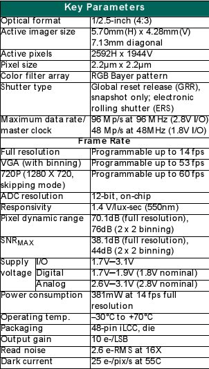

    Hi, this is our sensor's perameters
    According to the table, our sensor is 12 bit raw data sensor.

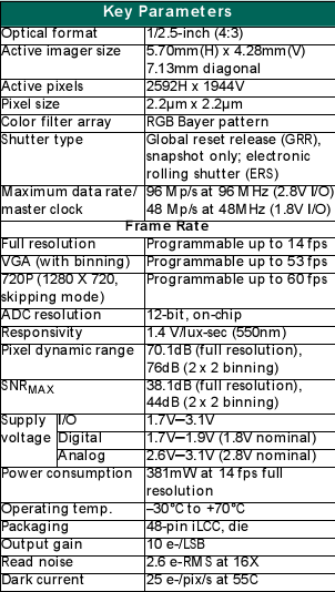

  • From my point of view:
    (1) the pink and color shift of the first picture is caused by sensor data non linearized, for example: the raw data from sensor at mid-tone could be Raw(R,G,B)=(64,128,100) then you should apply WB gain of Gain(2, 1, 1.28) to get gray of RGB(128,128,128), while for some parts of data at bright areas, the raw data curved to Raw(80, 150, 117) while you appling the same WB gain (2, 1, 1.28) makes RGB(160, 150, 150) then it turned to be redish as you saw in your first picture. The possible reasons of that could be: (a) non appropriate gain settings on sensor (the sensor data you provided looks like Aptina MT9P031), make sure you didn't set a gain under x1 (b) over subscribed the dark level (c) different gamma curve on each channel or... something else?
    (2) The 2'nd picture for me is quite difficult to understand. It's on the center part of the picture, while the distortion caused by lens us usually on the corner. The first bar curved to left while the bar behind it curved in the middle. But it still looks like optical issues for me. Could you try to clean up the lens and sensor cover glass, make sure there is absolutely clear, no glue, no un-uniform object on it? Or you may just change another lens and sensor to test again.
