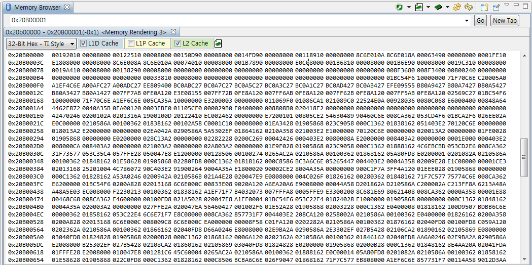

I posted problem of big endian on C6670 EVM board. But I couldn't find any solution. so I post again.
I have to use Big endian mode on C6670 EVM board. and I build big endian POST
and I programmed by eepromwriter_evmc6670l. but board didn't work
so I tried other way, I re-build POST, eepromwriter_emvc6670l. and I programmed by eepromwriter
It worked well. but I tried big endian mode, It didn't work
This is my way.
1. I re-build platform_lib_evmc6670l in Debug_BE configuration.
2. I re-build platform_lib_evmc6670l in Lite_BE configuration.
3. I modified post_evm6670l properties for big endian.
- I changed device endianess. ("little" to "big")
- I changed lib file ("ti.platform.evm6670l.lite.lib" to "ti.platform.evm6670l.lite.libe")
4. I re-build post_evm6670l in big endian.
5. I modified eepromwriter_evmc6670l for big endian, like 4
6. set my board for big endian, no boot mode.
7. board power up. and excute eepromwriter_evmc6670l.
8. set my board for big endian, I2C boot mode (0x50)
what I missed for ??
