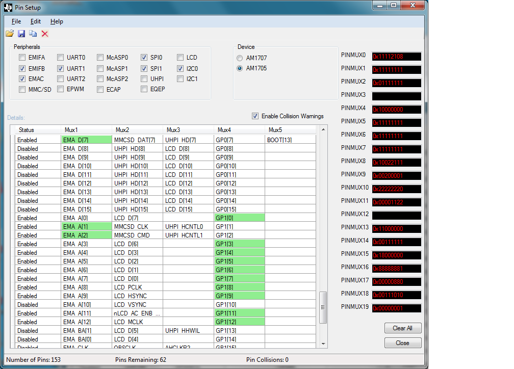

Things are working well with nand, no problems. What we are seeing is that once we mux the EMA_A[1] and EMA_A[2] for use as address lines to the nand device, the other unused EMA_A pins will not function as GPIOs even after muxing them to be GPIO.
We don't seem to be able to use GP1[0], GP[3]:GP1[12] with this muxing, these pins always read zero. GP1[13] and GP1[14], the bank address pins, do work as GPIOs. Or seem to. I can change their values from /sys/class/gpio.
I have looked in several places but can't find any documentation on this issue. Is this expected behavior once any address pin is muxed?
Here is a shot from the Pin Setup utility:
thanks,
Dan
  • Double check that your board file (arch/arm/mach-davinci/board-da830-evm.c) does not over write your mux config.
  • Hi Norman,
    I guess you are referring to this data structure from the board file?
     * UI board NAND/NOR flashes only use 8-bit data bus.
    static const short da830_evm_emif25_pins[] = {
        DA830_EMA_D_0, DA830_EMA_D_1, DA830_EMA_D_2, DA830_EMA_D_3,
        DA830_EMA_D_4, DA830_EMA_D_5, DA830_EMA_D_6, DA830_EMA_D_7,
        DA830_EMA_A_0, DA830_EMA_A_1, DA830_EMA_A_2, DA830_EMA_A_3,
        DA830_EMA_A_4, DA830_EMA_A_5, DA830_EMA_A_6, DA830_EMA_A_7,
        DA830_EMA_A_8, DA830_EMA_A_9, DA830_EMA_A_10, DA830_EMA_A_11,
        DA830_EMA_A_12, DA830_EMA_BA_0, DA830_EMA_BA_1, DA830_NEMA_WE,
        DA830_NEMA_CS_2, DA830_NEMA_CS_3, DA830_NEMA_OE, DA830_EMA_WAIT_0,
        -1
  • Thanks for the pointer, Norman!  They are working now. I changed the data structure as follows to match the pin mux.
        DA830_EMA_A_1, DA830_EMA_A_2, DA830_NEMA_WE,
        -1
