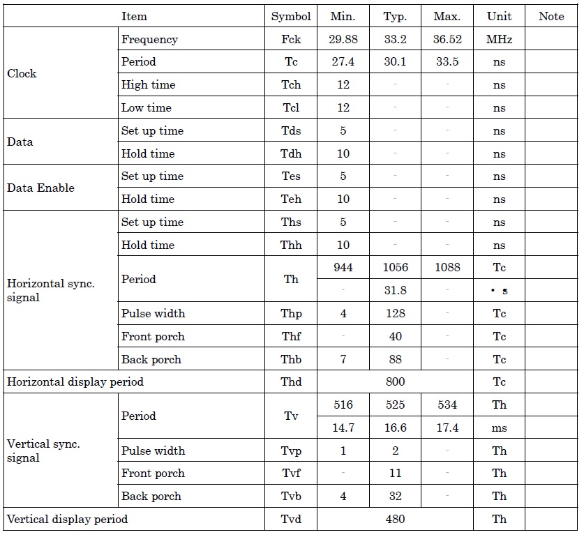

Hi, I am using Kyocera tft display of 800x480 resolution. in the display parameters, what the value I should specify for hsync and vsync. The hsync is specified as 1056 Tc and vsync is specified as 525 Th. Tc= 33MHz, Th = hsync.
I have attached the table of parameters from the data sheet. Please, reply asap as it is very urgent for me.
