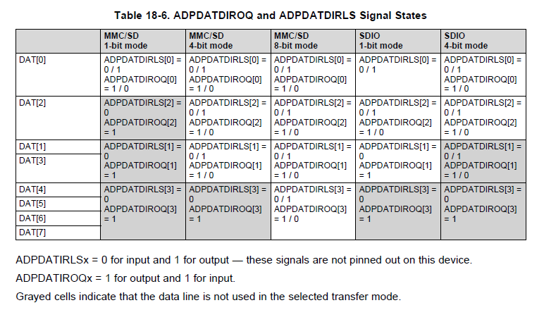

Would you please explain about the following Table which it is written in TRM?

This table must have been left in the TRM from the original IP spec. These signal are internal and not relevant from user point of view.
