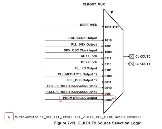

For our development testing using the custom board, we would like to measure PLL_DSP. For this, we intend to utilise the CLKOUT0 pin.
From the TRM, we understand that we need to tweak the CLKOUT_MUX register and set bits 3-0 as 0x0 [Source is PRCM_SYSCLK_OUT]. We identified PRCM_SYSCLK_OUT based on the CLKOUTx Source Selection Logic diagram from the datasheet as shown below.
But from the attached image, it seems like PRCM_SYSCLK_OUT is a muxed output of PLL_DSP, PLL_HDVICP, PLL_VIDEO0, PLL_AUDIO, and RTCDIVIDER.
How do we choose to output PLL_DSP only from above muxed options? Please correct us if i am missing something.

  • Padmanabhan,
    Padmanabhan KS said:
    From the TRM
    This Figure 7-11 is from the DM814x datasheet (SPRS647E), not DM814x TRM (SPRUGZ8E).
    Your understanding for the CLKOUT_MUX register is correct, you should select [3:0] CLKOUT0_MUX = 0x0 to export the PRCM output clock signal to the CLKOUT0 pin.
    The other register, which selects among the PRCM clock signals, is the CM_CLKOUT_CTRL. See DM814x TRM (SPRUGZ8E), section 2.3.11 Clock Output Pin and section 2.10.3.1 CM_CLKOUT_CTRL Register
    In TRM, the bit you need is: CM_CLKOUT_CTRL[1:0] CLKOUTSOURCE = 0x1: DPLL_DSP_CLK : USB PLL clock output

    This means CM_CLKOUT_CTRL[1:0] CLKOUTSOURCE = 0x0 for DSP_PLL
    I think that the linux kernel is the correct one, not the TRM. The DSP PLL output clock is 500MHz by default, so you should have this 500MHz value on the CLKOUT0 pin.
