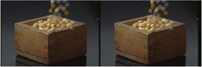

Test Case 1
I create the Capture(Resizer) & Encoders for the size of 720x480
No dynamic change case:
The Result
No Problem: I can get the normal H.264 & JPEG image of the size 720x480
JPEG(720x480) H.264(720x480)
Test Case 2
I create the Capture(Resizer) & Encoders for the size of 352x240
The Result
No Problem: I can get the normal H.264 & JPEG image of the size 352x240
JPEG(352x240) H.264(352x240)

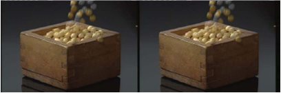

Test Case 3
I try to dynamic change from 720x480 to 352x240 for the Capture(Resizer) & Encoders.
The Result
I got the abnormal JPEG & H.264 image of the size 352x240
I think the Y is normal but the color is not correct to image.
Test Case 4
I try to delete & create for JPEG & H.264 encoders when the image size is changed.
The Result
No Problem & Problem:
I can get the normal JPEG image of the size 352x240
But I can get the abnormal H.264 image of the size 352x240

  • Dear YK Jung,
    I am thinking that the buffer address set for Chroma data for both JPEG and H.264 encoder is wrong. How do you calculate the address for the chroma data for JPEG and H.264? Can you check that the difference between Y data address and UV data address is 352x240 after you change the resolution using dynamic switching?
    Also, we need the exact values of parameters you set for H.264 encoder dynamic params and also the addresses and size you set for the VIDENC1_process inArgs.
    Anshuman
  • Dear Anshuman,
    First of all thanks soooooo much.
    I think it is correct clue.
    I am using “dmai" library. So I call only the function "Venc1_process()" in Venc1.c and call the function "Ienc1_process()" in Ienc1.c.
    The files is located in "dvsdk_2_10_01_18\dmai_1_21_00_10\packages\ti\sdo\dmai\ce\".
    I just think the “dmia” library will be running well and  Now I don't understanding how can I calculate the address for the chroma data for JPEG and H.264.
    But I try to find out the problem in the functions "Venc1_process()" and "Ienc1_process()" as you mention that.
    If you can check the problem in the functions, please let me know.
  • Dear YK Jung,
    I assume you have the following code in the Venc1.c file inside DMAI.
    if (BufferGfx_getColorSpace(hInBuf) == ColorSpace_YUV420PSEMI) {
            inBufDesc.bufDesc[0].bufSize    = hVe->minInBufSize[0];
            inBufDesc.bufDesc[1].bufSize    = hVe->minInBufSize[1];
            inBufDesc.bufDesc[0].buf        = inPtr;
            inBufDesc.bufDesc[1].buf        = inPtr + Buffer_getSize(hInBuf) * 2/3;
            inBufDesc.numBufs               = 2;
    Can you please print the values of inBufDesc.bufDesc[0].buf  and inBufDesc.bufDesc[1].buf, just after this if condition routine. I am suspecintg that Buffer_getSize might cause an issue in dynamic switching case. Also, as per my last suggestion, try changing the addresses of these two buffers (Y and UV) in the above code sucha that inBufDesc.bufDesc[0].buf = inPtr;
    and
    inBufDesc.bufDesc[1].buf = inPtr + (352*240);
    or
    inBufDesc.bufDesc[1].buf = inPtr + (736*480);
    Anshuman
  • Dear Anshuman,
    Your comment is perfect!!!!!!!!
    I confirm this problem.
    Thanks so much again.
    Sincerely yours,
    YK-Jung(YongKil JUNG).
