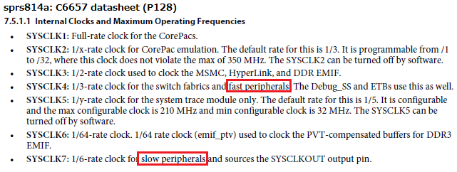

I would like to clarify C665x's slow peripherals and fast peripherals.
I am assuming as following.
Slow peripherals are: EMIF16, GPIOs, I2C, UART, SPI, McBSP, Timers
Fast peripherals are: uPP, PCIe, SGMII, MDIO, Multicore Navigator, Packet DMA, Queue Manager, TCP3d, VCP2, EDMA
Is that correct?
If there is any misunderstanding, please correct.
