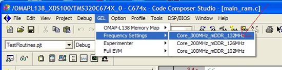

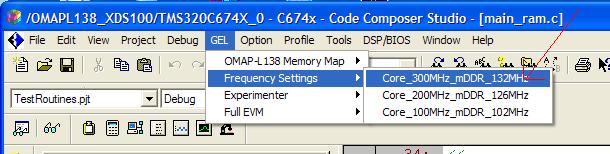

    It seems like the GEL file that comes with OMAP-L138 does not configure DDR unless you use the menu, so please make sure to run in CCS:
    So at least now the numbers are consistent. Joe, can you take a look at the C code and see if there is a way of making it more efficient? Please also take a look at the ASM code.
