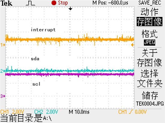

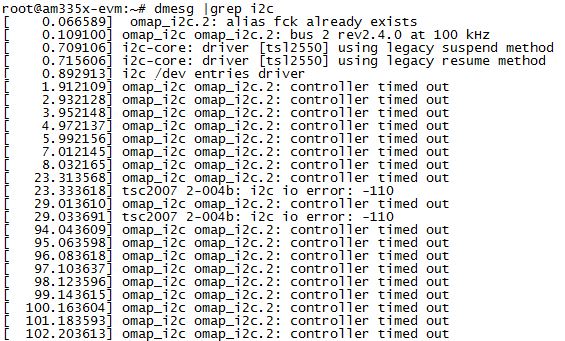

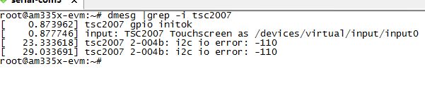

tsc2007 i2c irq
Other Parts Discussed in Thread: TSC2007
/*added to devices.c*/
static struct resource tsc2007_resource[] = {
                  .start          = OMAP_GPIO_IRQ(GPIO_TO_PIN(0, 12)),
                   .end           = OMAP_GPIO_IRQ(GPIO_TO_PIN(0, 12)),
                  .flags          = IORESOURCE_IRQ,
  static struct platform_device tsc2007_device = {
          .name           = "tsc2007",
          .id             = -1,
          .num_resources  = ARRAY_SIZE(tsc2007_resource),
          .resource       = tsc2007_resource,
/* added to board-am335xevm.c*/
# define TSC2007_INT_GPIO  GPIO_TO_PIN(0, 12)
 static int tsc2007_hw_init(void)
    int err;
    err=gpio_request(TSC2007_INT_GPIO,"tsc2007 irq");
    if(err){
                pr_err("tsc2007 irqgpio request err\n");
                return err;
    err=gpio_direction_input(TSC2007_INT_GPIO);
    if(err){
                pr_err("tsc2007 irqgpio init input err %d\n",err);
                gpio_free(TSC2007_INT_GPIO);
                return err;
    setup_pin_mux(tsc2007_irq_pin_mux);
    printk("tsc2007 gpio initok\n");
    return 0;
 static void tsc2007_hw_remove(void)
static int tsc2007_get_pendown_state(void)
    return !gpio_get_value(TSC2007_INT_GPIO);
static struct tsc2007_platform_data tsc2007_info = {
    .model          = 2007,
    .x_plate_ohms       = 180,
    .get_pendown_state = tsc2007_get_pendown_state,
    .init_platform_hw=tsc2007_hw_init,
    .exit_platform_hw=tsc2007_hw_remove,
static struct i2c_board_info tsc2007_i2c_devices[] = {
        I2C_BOARD_INFO("tsc2007", 0x4B),
        .type       = "tsc2007",
        .platform_data  = &tsc2007_info,
        .irq        = OMAP_GPIO_IRQ(TSC2007_INT_GPIO),
/* Module pin mux for tsc2007 */
static struct pinmux_config tsc2007_i2c1_pin_mux[] = {
    {"spi0_d1.i2c1_sda",    OMAP_MUX_MODE3 | AM33XX_SLEWCTRL_SLOW |
                    AM33XX_PULL_ENBL | AM33XX_INPUT_EN},
    {"spi0_cs0.i2c1_scl",   OMAP_MUX_MODE3 | AM33XX_SLEWCTRL_SLOW |
    {NULL, 0},
static struct pinmux_config tsc2007_irq_pin_mux[] = {
    {"uart1_ctsn.gpio0_12",   OMAP_MUX_MODE7 | AM33XX_PIN_INPUT},
    {NULL, 0},
static void i2c1_init(void)
    setup_pin_mux(tsc2007_i2c1_pin_mux);
    omap_register_i2c_bus(2, 100, tsc2007_i2c_devices,
            ARRAY_SIZE(tsc2007_i2c_devices));
    return;
static void __init am335x_evm_init(void)
  i2c1_init();
