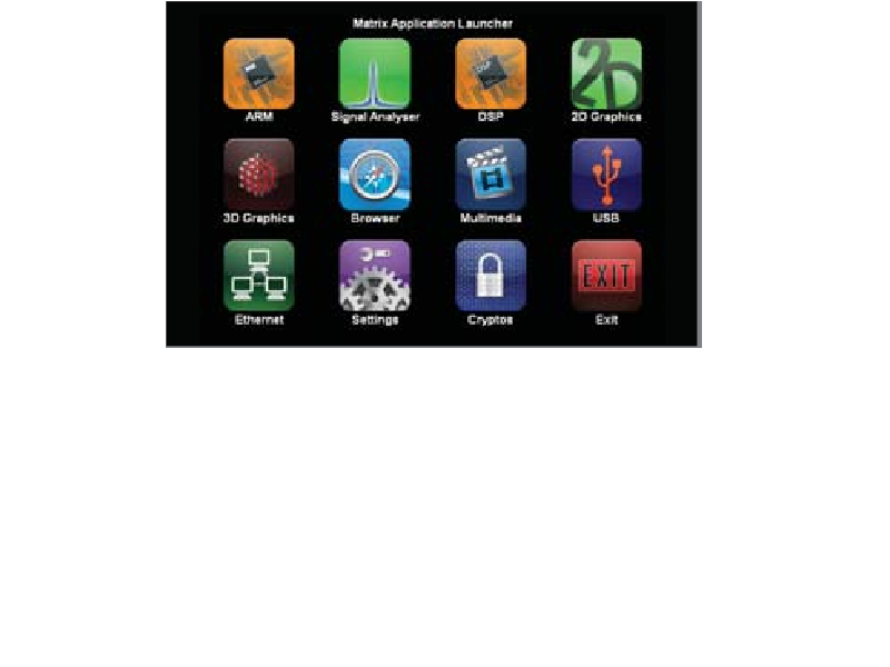

    Provide the booting log also the commands that you are executing before the pipeline execution.
    When the FS loads are you seeing the graphic plane on the HDMI/LCD?
    Margarita
    I am not seeing any image in the display device. But the power is enabling in the HDMI. Seem like the plane is visible in the HDMI.
    I have attached the complete log file with this.
    I can't understand this.
    When the FS loaded are you seeing this before to execute anything?
    Margarita
    I have used the default binaries to boot the system. I am seeing the graphics plane in my HDMI. But in customized image its not displaying. What might be the issue in that?. Also I can't able to switch my default display from HDMI to LCD.
    Please suggest any solution to solve this issue.
    Thanks in advance.
    Salih
    Thank you very much for your support. I have fixed this issue, that there is a problem with my customized kernel. Now its working fine in the HDMI. Currently, I want to test the matrix-GUI in my LCD device with the resolution of 800x480. But if I switched the display to LCD, the resolution is not proper. Can you help me out on what to do to fix this issue. I have executed below commands to switch the display.
    echo 0 > /sys/devices/platform/vpss/graphics0/enabled
    echo 1:dvo2 > /sys/devices/platform/vpss/graphics0/nodes
    echo 0 > /sys/devices/platform/vpss/display1/enabled
    echo 800x480@60 > /sys/devices/platform/vpss/display1/mode
    echo 1 > /sys/devices/platform/vpss/display1/enabled
    echo 1 > /sys/devices/platform/vpss/graphics0/enabled
