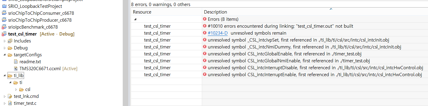

I build project and faced some errors.
unresolved symbol CSL_intclvpSet, CSL_inctGlobalEnable.....
I cannot find the sources of unresolved symbols below \ti\csl folder
Please let me know how to use CSL properly.
