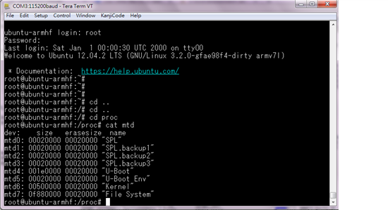

I want use fw_env.config to print u-boot enviroment variables in kernel userspace
but I don't know how to set value for each entry. Could you help me to fill the blank ?
Thank you.
u-boot/include/configs/am335x_evm.h
#define CONFIG_ENV_SIZE (128 << 10)
#define CONFIG_ENV_SECT_SIZE (4 << 10) /* 4 KB sectors */
#define CONFIG_ENV_OFFSET (768 << 10) /* 768 KiB in */
#define CONFIG_ENV_OFFSET 0x260000 /* environment starts here */
And How do I set fw_env.config?
MTD device name ----> ?
Device Offset -----> 0x260000??
Environment Size -----> ?
Flash sector size ------> ?
