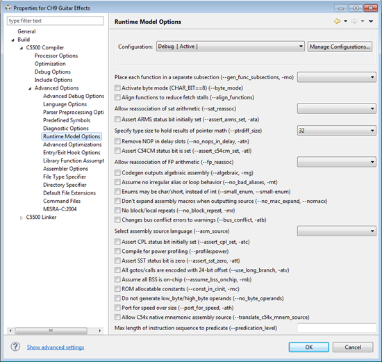

    Thanks so much for your quick reply, I was looking for the aic3204.c and .h files with a function to change the gain and samples too. I'm trying to read in signals from an electric guitar, it works fine for line in but I get nothing when I just plug a guitar in, so I think I need to up the gain in, I tried to do this by changing the register values on 59 and 60 but with no luck.
    Do you have a version of the teaching ROM for the 5515 instead of 5505? I looked at the link and chapter 9 would work very well but won't compile ("error 5369 this XAR may corrupt the upper 7 bits..." and a couple of error 9999) I'm assuming because it's a miss match of 5505 to 5515.
    James
  • James,
    The C5505 Teaching ROM was intended for C5505 and C5515 eZdsps.
    Both C5505 eZdsp and C5515 eZdsp share the same audio codec and it is on the same I2S port, so examples that run on the C5505 should run on the C5515 also.
    Chapter 20 is specifically for C5515 eZdsp - it uses its OLED display, which is not present on C5505 eZdsp
    In this teaching ROM the project files must be created manually, then files imported. See Chapter 1 for specific project settings like ptrdiff_size = 32 and memory model = huge.
    Anyway, I have created the project files in the attached zip. Try it out.
    Screen shots show CCS5.5 project settings for ptrdiff_size = 32 and memory model = huge
    Hope this helps,
    Mark
