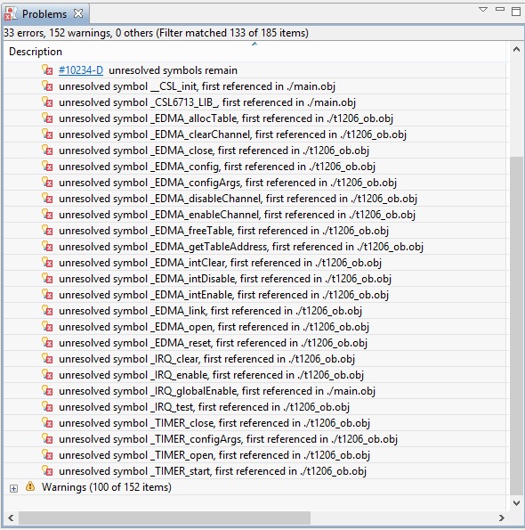

    I have run this code in ccsv3.1 successfully and it works great. However, is it possible to get a CCSv5.4 version of either this version of the code or the 3.3v? I tried importing the 3.3 version however I get errors error when I try to debug:
    Any info you could provide on how to get this valuable code to a higher version would be greatly appreciated.
