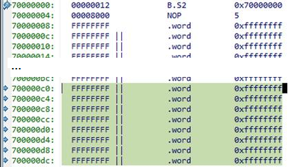

One of my important customer made their custom C6655 board.
And, they are evaluating EMIF16 NOR boot on it.
They are putting loop forever operation code (0x00000012) on EMIF base address (0x70000000).
And, they can see PC jumps to the address (0x70000000) after reset.
But, actual operation is unexpected. It just pass through the loop forever.
When I put the same operation code (0x00000012) in internal RAM area, expected operation can be observed.(Loop forever)

  • Rahul-san,
    Hello.
    I found causing of this issue.
    When I modified binary code like following, I could see expected operation.
    And I also could reproduce it in SRAM area.
    False operation A): "B" instruction is ignored
      B 0x70000000
      NOP 5
      .word 0xFFFFFFFF
      || .word 0xFFFFFFFF
      || .word 0xFFFFFFFF
      || .word 0xFFFFFFFF
      || .word 0xFFFFFFFF
      || .word 0xFFFFFFFF
    False operation B): "B" instruction is ignored
      B 0x70000000
      NOP 5
      NOP
      NOP
      NOP
      NOP
      NOP
      .word 0xFFFFFFFF
    Expected operation: C66x operate loop infinite
      B 0x70000000
      NOP 5
      NOP
      NOP
      NOP
      NOP
      NOP
      NOP
    Question)
    Therefore, we are guessing that:
    - Undefined operation code("|| .word 0xFFFFFFFF") corrupts CPU operation.
    - Since instructions are always fetched 8 words at a time,
    undefined operation code must NOT be placed in 8 words.
    Is my understanding correct?
    We are looking for the description of its restriction in the User's guide.
    If you know the place, please let me know.
    Best regards, RY
