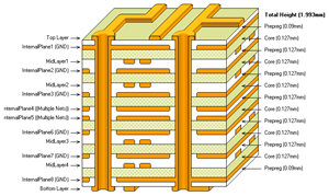

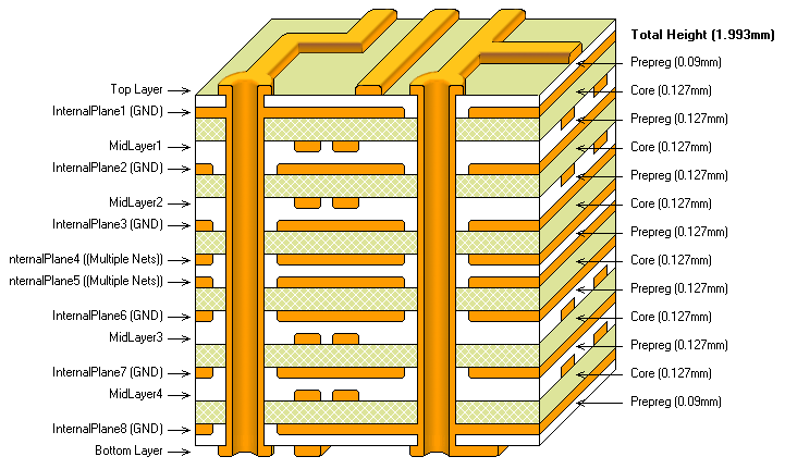

  • Hi Tom,
    I can answer some of these.All of the fly-by signals do indeed get routed to the right-most device first, so the ordering is correct. It's not absolutely ideal, since most of the signals go through one extra via to the right of this device, but a few signals go directly to the break-out vias of it. I didn't see this as much of an issue though since we're not intending to run this memory very fast. 400MHz (800Mbps) would be plenty.
    The stack-up is as shown here:
    All DDR3 signalling is done through Mid-layers 1-4 which all have a solid ground plane above and below them. All of the power planes are squeezed into the middle two split planes. I've checked the continuity of every signal's return path ensuring that there are enough GND vias close to all layer transitions, so this shouldn't be an issue.
    I couldn't quite break out all the signals of each data group on the same layer, so the via barrels will incur a slight length-matching discrepancy on the odd signals. I think the worst case is 20mils (0.2% of a bit-length@800Mbps). Unfortunately, our layout software isn't clever enough to take barrel lengths into account, but I thought this amount of skew would be negligible.
    As for the segment length matching between devices, again our software doesn't really make this easy to do. I did provide net-ties at the last device so that the tracks between the last device and the terminating resistors was not included in the length-matching. The worst-case cumulative matching error will certainly be less than 1% of a bit-length, so I can't see how this would break anything. I could try to measure all the tracks to get the exact numbers, but it may take a few days.

  • Richard,
    I agree that the length matching skew issues would be minimized when operating at 800MT/s (400MHz DDR3 CLK).  If you evern intend to increase the data rate, I recommend that you have the layout team properly constrain the layout so that it meets the length matching guidelines.
    That being said, the layout as you described it should be functionally robust at 800MT/s.  There appears to be some other fundamental issue.  I am concerned that it is hidden by your attempts to debug the DDR behavior while using Linux.  We always recommend that the DDR3 implementation be validated using CCS and GEL files.  Then once the board layout and the configuration are known to be robust, then you integrate the Linux environment with the proven configuration.
    Additionally, DDR3 memory is not located at 0x8000_0000.  This location is reserved.  DDR3 memory is located at 0x08_0000_0000.  This is visible from the ARM cores.  However, it is not directly visible from the DSP core of the other SOC masters unless the MPAX is properly configured.  Please refer to the last few lines of Table 6-1 in the K2E Data Manual and the footnotes below it.
    DDR3 devices are not rated for operation below 666MT/s and the DDR3 PHY on K2E is not rated for operation below 800MT/s.  Operation below these rated is not allowed.
    I recommend that you shift your DDR3 validation back to use of CCS the GEL file.  The K2 DDR3 Init App Note is now on-line at: http://www.ti.com/lit/pdf/sprabx7.  The productized K2 REG_CALC spreadsheet can be linked from it.  Please populate a copy of this spreadsheet and post it.
    Tom
