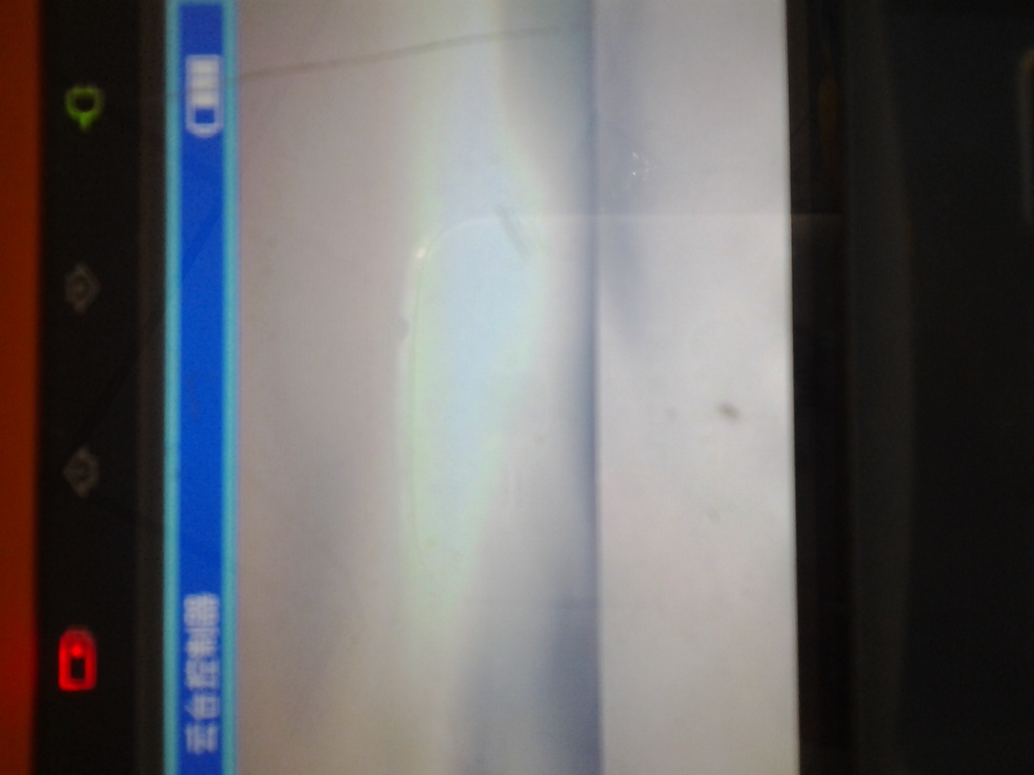

I failed again when I did follow your advice.
fbdev config:
cd /sys/devices/platform/vpss/display2/
echo 0 > enabled
echo composite > output
echo ntsc > mode
echo 1 > enabled
cd -
displayLink config:
gVdisModuleContext.displayId[0] = SYSTEM_LINK_ID_DISPLAY_2;
192 MULTICH_INIT_STRUCT(DisplayLink_CreateParams,displayPrm[0]);
193 displayPrm[0].inQueParams[0].prevLinkId = gVcapModuleContext.sclrId[1] ;
194 displayPrm[0].inQueParams[0].prevLinkQueId = 0;
195 displayPrm[0].displayRes = VSYS_STD_NTSC;
196
197
198 System_linkCreate (gVcapModuleContext.captureId, &capturePrm, sizeof(capturePrm));
199 System_linkCreate(gVcapModuleContext.sclrId[0], &mpSclrPrm1, sizeof(mpSclrPrm1));
200 System_linkCreate(gVcapModuleContext.sclrId[1], &sclrPrm1, sizeof(sclrPrm1));
201
202 System_linkCreate(gVdisModuleContext.displayId[0], &displayPrm[0], sizeof(displayPrm[0]));
linkChains:
cature(2448*2048) -> mpscalar (1080p) -> scalar(ntsc) -> display
is there any error ? 3Q
