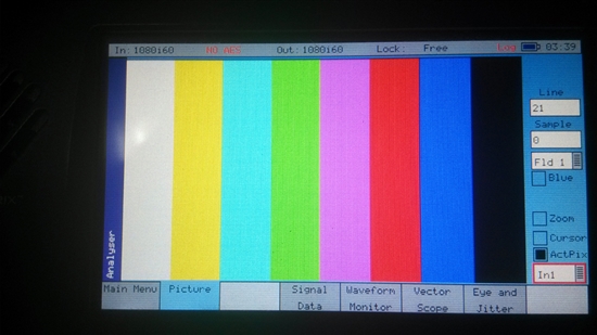

It probably can work, but the video output is abnormal, It looks like that the Vsync is not synchronized.
Please refer to the the attached video!
But when I enable the HD_VENC self test mode, I can get a good video output.

    Here is the configuration we wanted: AUXOSC (27MHz) -> DPLL_VIDEO1 -> HDVPSS VOUT0
    When use DEVOSC as the DPLL_VIDEO1 clock source, we could not obtain an accurate pixel clock frequency for same special resolutions such as 1080I59.94(74.176MHz)、1080P59.94(148.352MHz). We want to use AUXOSC to produce a precise video pixel clock for VOUT0.
    I think I've found the cause of the problem: when i changed TI814X_OSC_FREQ to 27MHz, the function system_getdividers() return -EINVAL, it led to the PLL setting failed in function Vps_system_setpll().
    Could you tell me how to fix it?
    Sivan
    This is correct.
    I do not think that function system_getdividers() from /drivers/video/ti81xx/vpss/system.c file is configuring anything related to DPLL_VIDEO1. This function/file is related to some of the other video PLLs (DPLL_VIDEO0, DPLL_VIDEO2/HDMI, DPLL_DSS/HDVPSS), but not to the DPLL_VIDEO1. I state this by the fact that DPLL_VIDEO1 is not locked, but is in bypass mode, thus provides the input frequency (20MHz, 22.579MHz or 27MHz) to the output without change/increase it.
