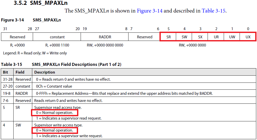

I have a confirmation about MSMC MPAX function.
There is a statement of "0=Normal operation" on SMS_MPAXLn[5:0].
My understanding is:
  - "Normal operation" means "accesses disallowed".
  - And, if any accesses occured on its "Normal operation" segment,
    Memory protection fault operation will happen.
Is my understanding correct?
Best regards, RY
