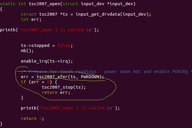

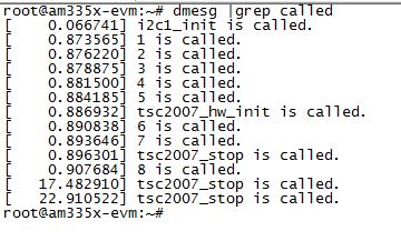

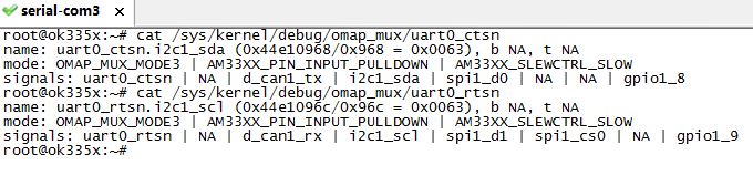

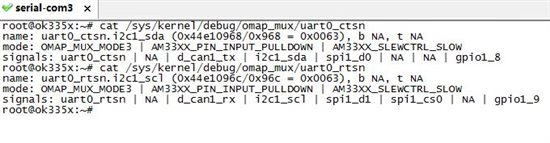

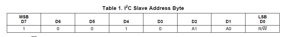

am335x i2c, there is no any waveform at sda and scl.
Other Parts Discussed in Thread: TSC2007
now, i'm trying to make the tsc2007 work.but there is no any waveform at sda and scl. here is my code.the tsc2007 is at 0x4B on i2c1.

static struct pinmux_config i2c1_pin_mux[] = {
	{"uart0_ctsn.i2c1_sda",    OMAP_MUX_MODE3 | AM33XX_SLEWCTRL_SLOW |
		AM33XX_PULL_ENBL | AM33XX_INPUT_EN},
	{"uart0_rtsn.i2c1_scl",   OMAP_MUX_MODE3 | AM33XX_SLEWCTRL_SLOW |
	{NULL, 0},

 static int tsc2007_hw_init(void)
	 int err;
	 setup_pin_mux(tsc2007_pin_mux);
	 err=gpio_request(TSC2007_INT_GPIO,"tsc2007 irq");
	 gpio_request(TSC2007_LED_GPIO,"tsc2007 led");
	 if(err){
		 pr_err("tsc2007 irqgpio request err\n");
		 return err;
	 err=gpio_direction_input(TSC2007_INT_GPIO);
	 gpio_direction_output(TSC2007_LED_GPIO, 1);
	 //gpio_direction_output(TSC2007_LED_GPIO, 0);
	 if(err){
		 pr_err("tsc2007 irqgpio init input err %d\n",err);
		 gpio_free(TSC2007_INT_GPIO);
		 return err;
	 printk("tsc2007_hw_init is called.\n");
	 return 0;
#endif

static struct i2c_board_info am335x_i2c1_boardinfo[] = {
		I2C_BOARD_INFO("tsc2007", 0x4b),
		.type		= "tsc2007",
		.platform_data	= &tsc2007_info,
		.irq		= OMAP_GPIO_IRQ(TSC2007_INT_GPIO),
static void i2c1_init(void)
	setup_pin_mux(i2c1_pin_mux);
	omap_register_i2c_bus(2, 100, am335x_i2c1_boardinfo,
			ARRAY_SIZE(am335x_i2c1_boardinfo));
	printk("i2c1_init is called.\n");
	return;

    	void			(*clear_penirq)(void);
    static inline int tsc2007_xfer(struct tsc2007 *tsc, u8 cmd)
    	s32 data;
    	u16 val;
    	printk("tsc2007_xfer 1 is called.\n");
    	printk("client's addr is %d.\n", tsc->client->addr);
    	data = i2c_smbus_read_word_data(tsc->client, cmd);
    	if (data < 0) {
    		dev_err(&tsc->client->dev, "i2c io error: %d\n", data);
    		return data;

  • tsc2007_xfer(ts, PWRDOWN) failed everytime.
  • Do you see the debug message "i2c1_init is called.\n"?

  • What is the I2C device physical address? How are the A1 and A0 pins tied on the TSC2007?
  • I2C device physical address is 0x4B. A0 and A1 are pulled up.
  • So everything seems fine on the HW side. Guess you'll have to see why you get this "i2c io error -121", but I'm not that much of a SW expert to help on that.
  • thank you. does anybody else know it? >.<''

  • thank you. this is a problem, i will correct it soon. but how can you explain the i2c problem??????
    Why do you have the internal pull-down enabled?  It's also illegal to use slow slew...
