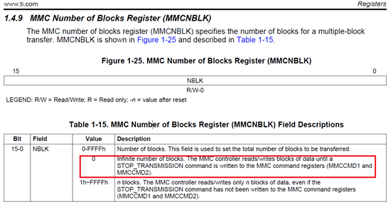

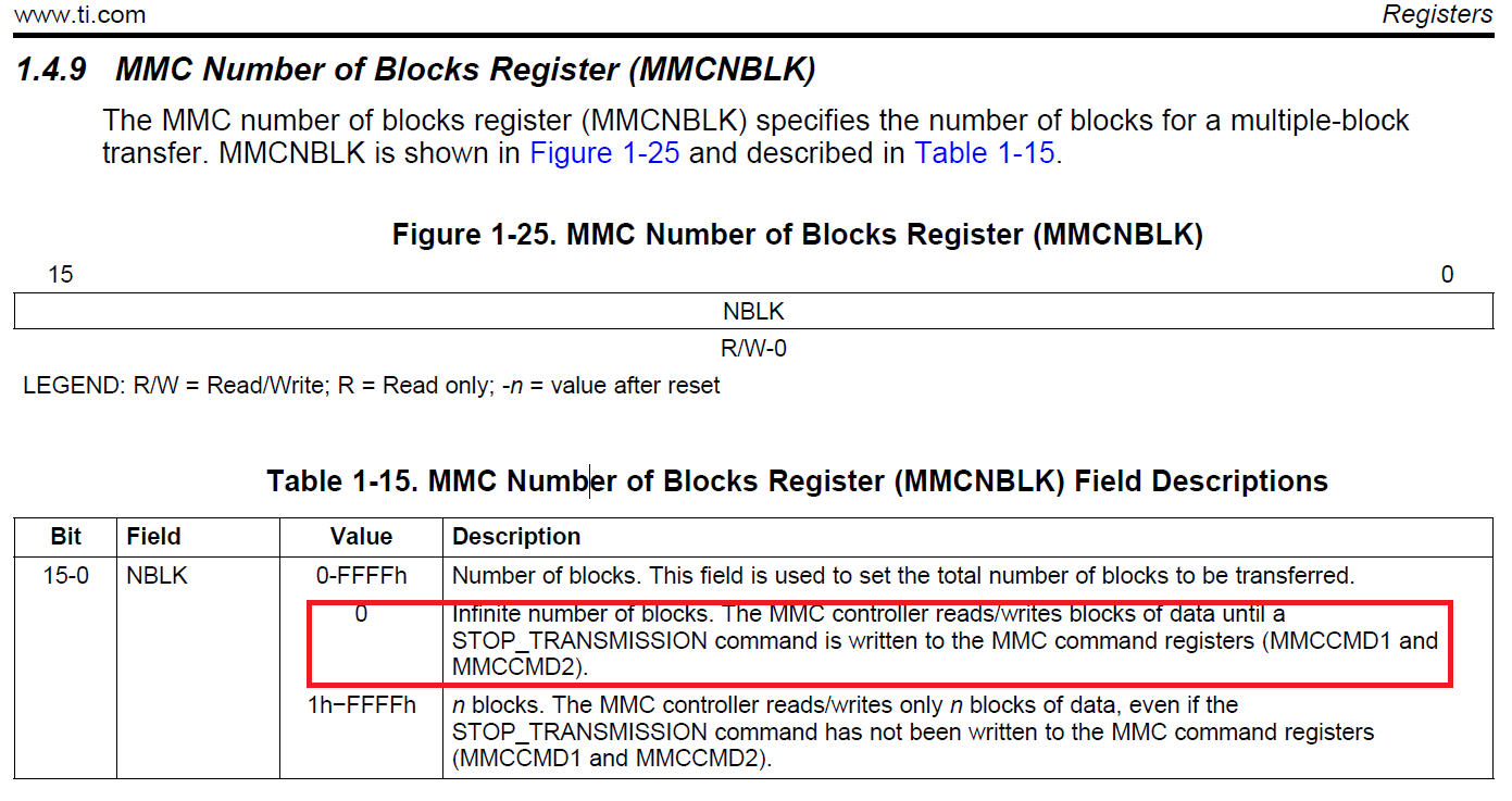

I want to write some data on SD card through multiple write command. (DMA transfer)
Could anyone help me write data to SD card when setting MMCSD register MMCNBLK to 0 (sequential write) ??

The default value is "0". Use break points when running the example to trace this register value.
