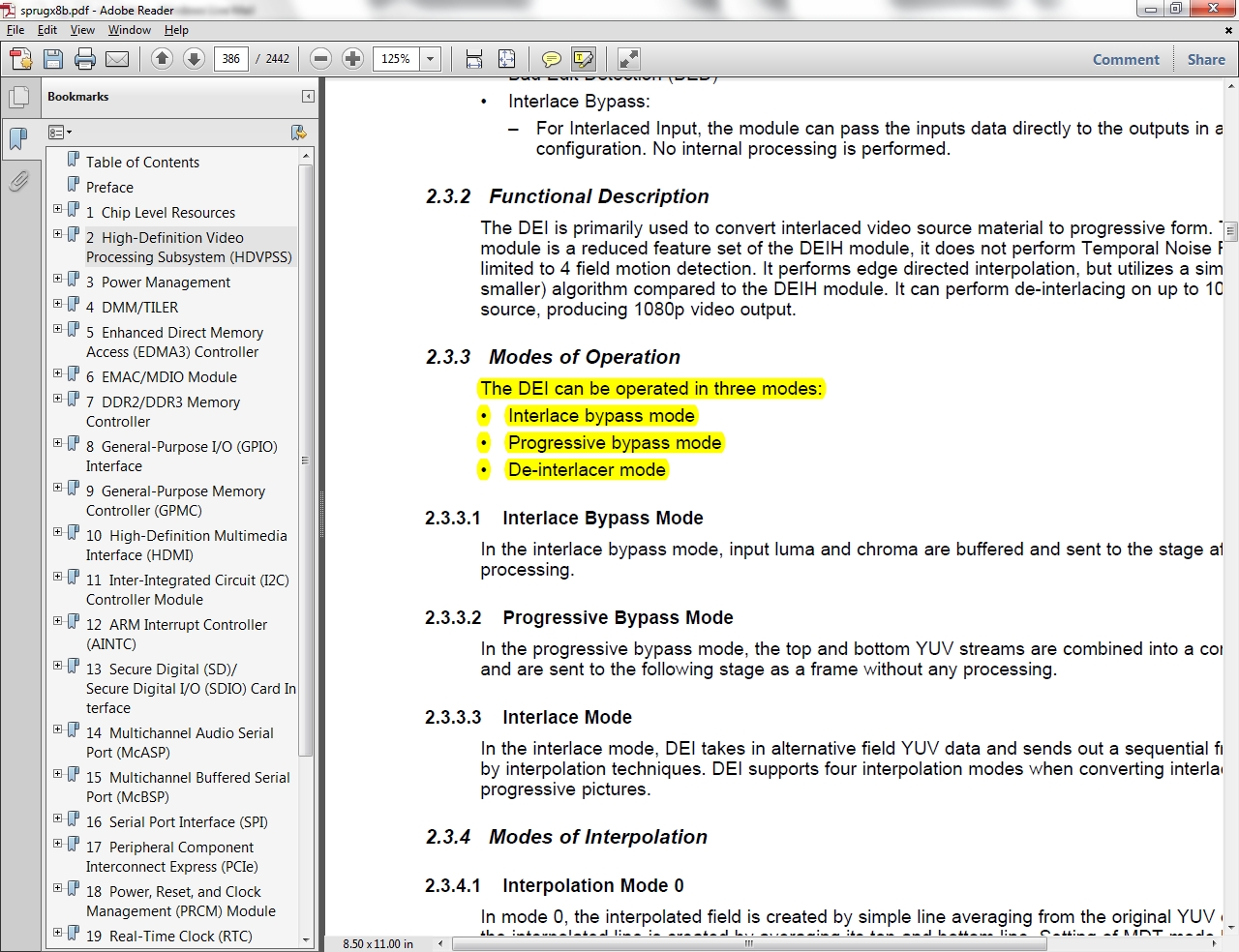

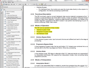

Hi Margarita,
Thanks for your response. I have referred the section as per your suggestion. I need one clarification regarding this DEI.
I want to know where I have to change this settings in my capture driver?. There are 3 modes in DEI. By default, which mode is setting in the capture driver?. And if I want to change it to some other mode where I need to change it in my Capture driver?.
I am attaching the types of mode in DEI which are mentioned in the Reference manual.
Thanks in advance.
Salih
