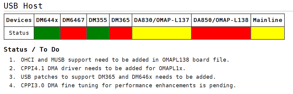

  • Thanks for your reply
    Maybe this caused by CPPI4.1 DMA Driver.
    http://processors.wiki.ti.com/index.php?title=DaVinci_GIT_Linux_Kernel#USB_Host
    And we must use linux3.8.0, beacuse we will add ipc3.x to the kernel. Any idea about “add CPP4.1 DMA driver for OMAPL1X”?
