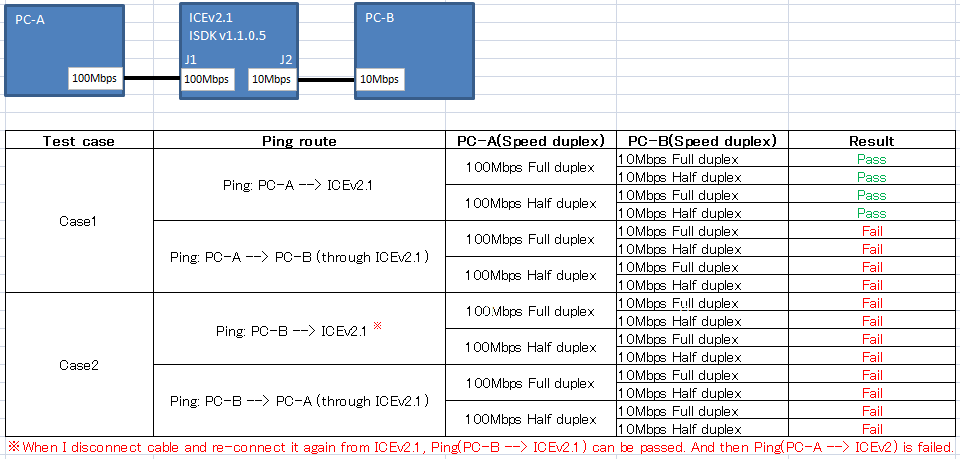

AM335x ISDK v1.1.0.5 Ethernet/IP : Ping can not pass between PC-A and PC-B through ICEv2.1
Guru 10570 points
I am using ICEv2.1(AM335x).
And, I am evaluating EthernetIP with ISDK v1.1.0.5.
I found issue that "Ping can not pass between PC-A and PC-B through ICEv2.1".
Question)
- Have you ever known this issue?
- Does it depend on hardware restriction? or software restriction?
- Do you have a plan to fix it?
Our Exam)
Best regards, RY
