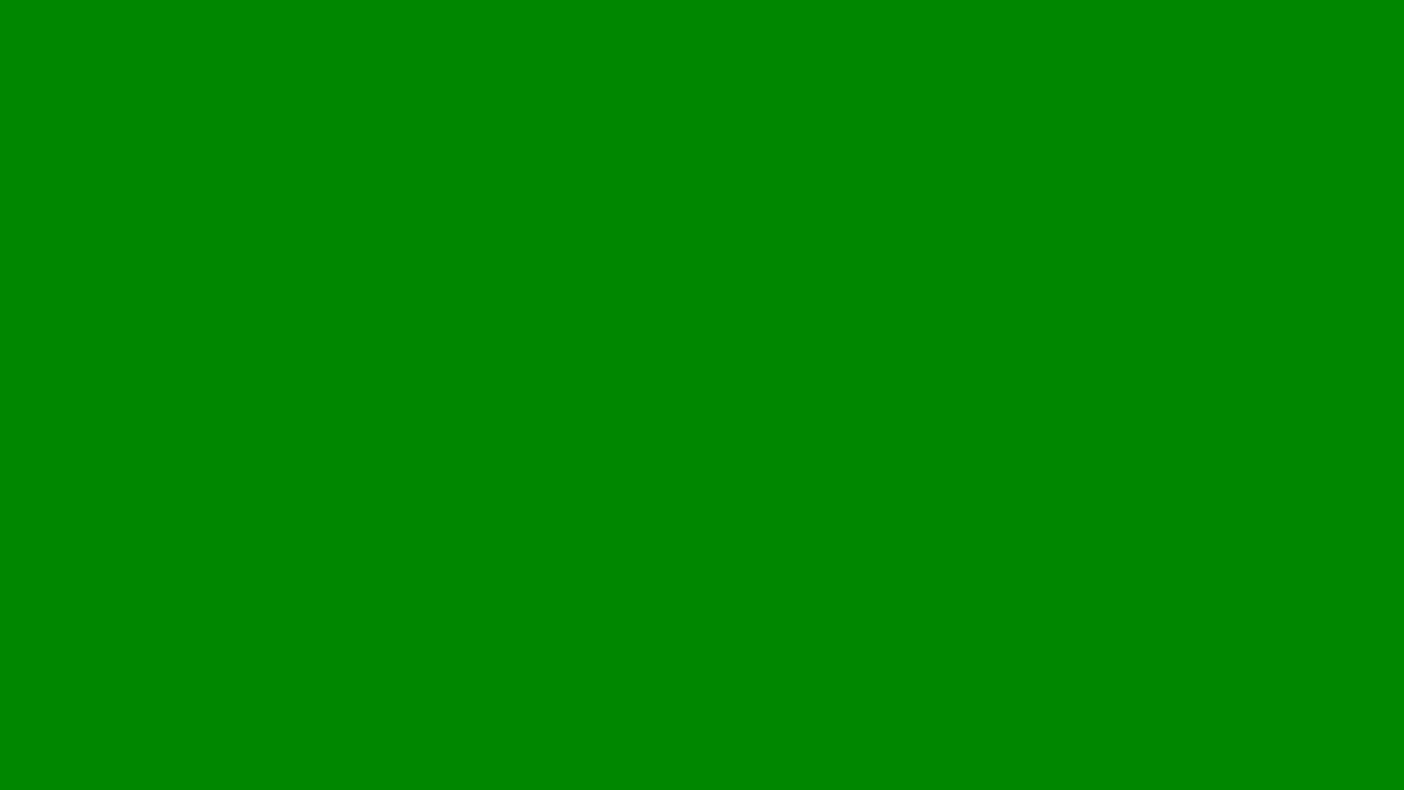

I have a problem with the VPBE and I hope that someone can help me!

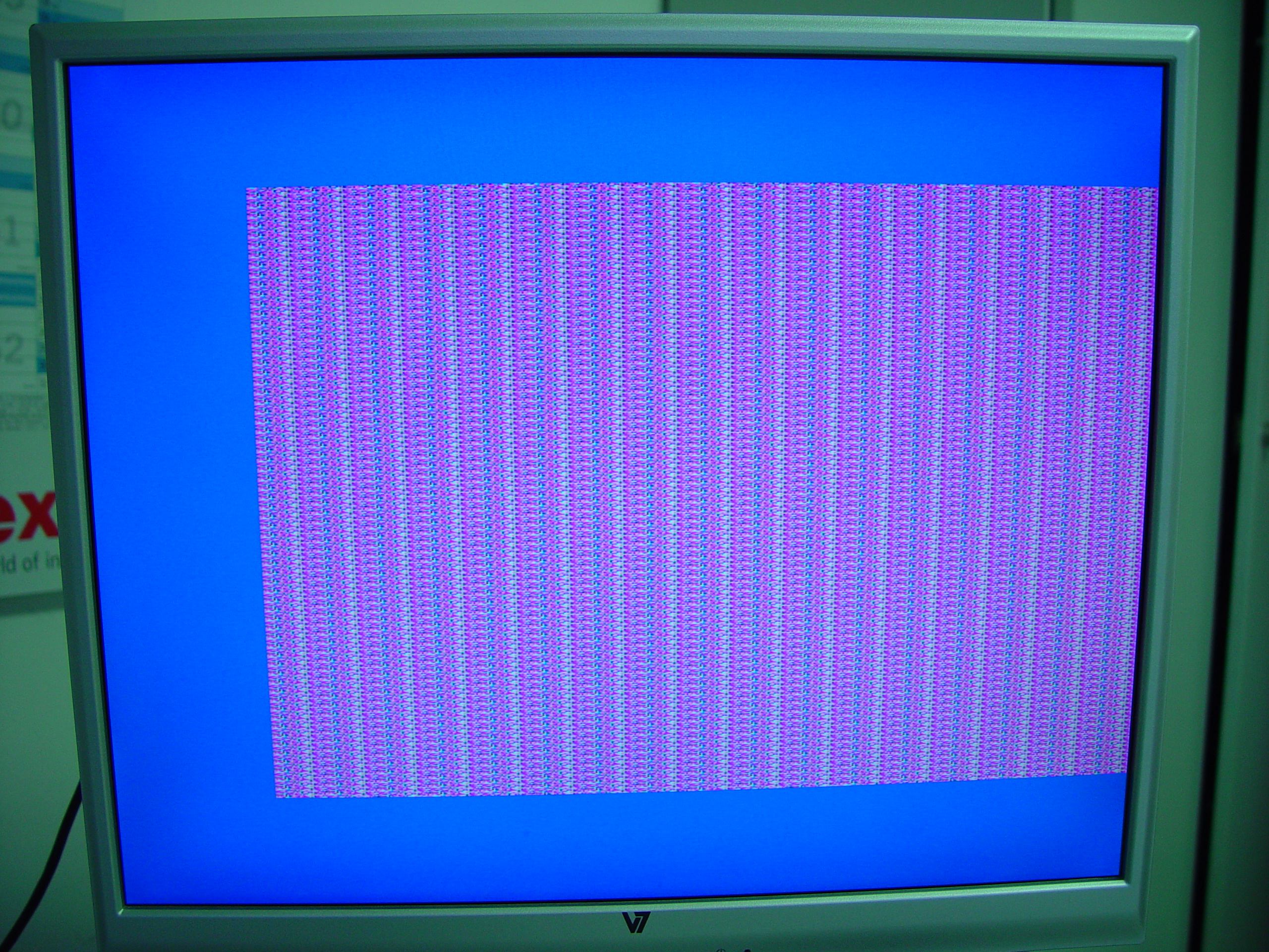

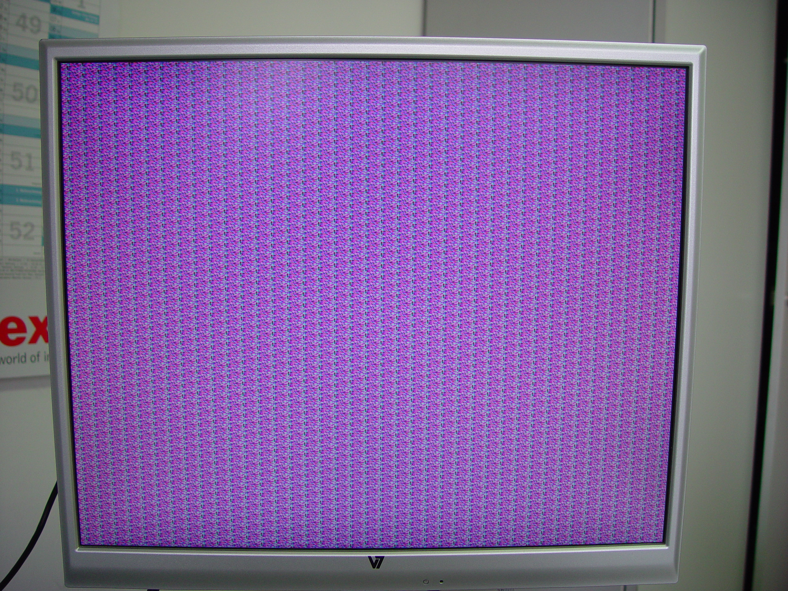

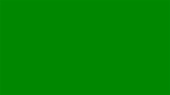

I managed to get the VPBE running in 720p60 mode with custom timings and digital output. But after setting the SDRAM register my monitor doesn't show what I wrote into the frame buffer (see figure 1 and 2).
Figure 1(on the left): VRAM buffer saved to file - all pixel in VRAM buffer are set to the same value
Figure 2(on the right): Monitor displaying data from VRAM buffer

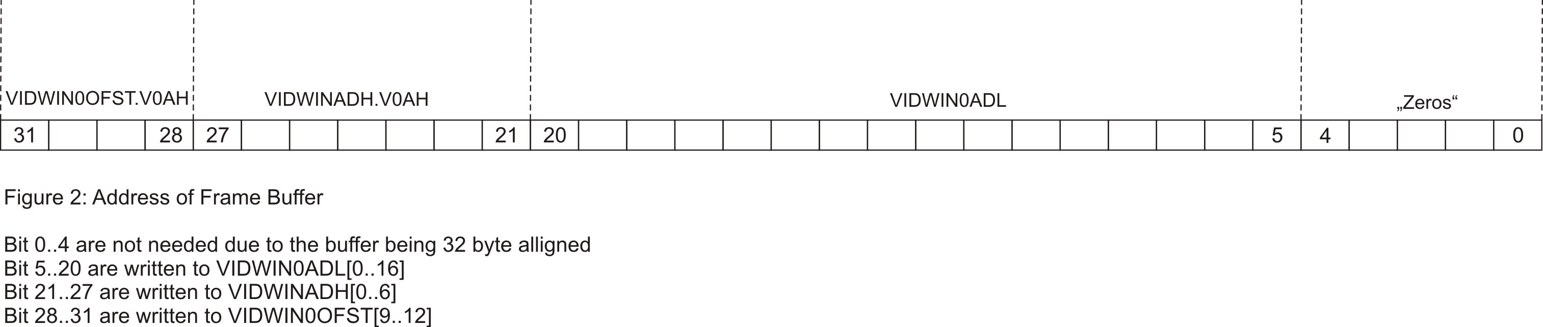

From another  post I know that setting the SDRAM address is a bit tricky, so I made a diagram to show how I set the address:
Are the register correct?
For setting the BASE-Pixel register and correct timings I will make another post...
Thanks in advance,
Sebastian

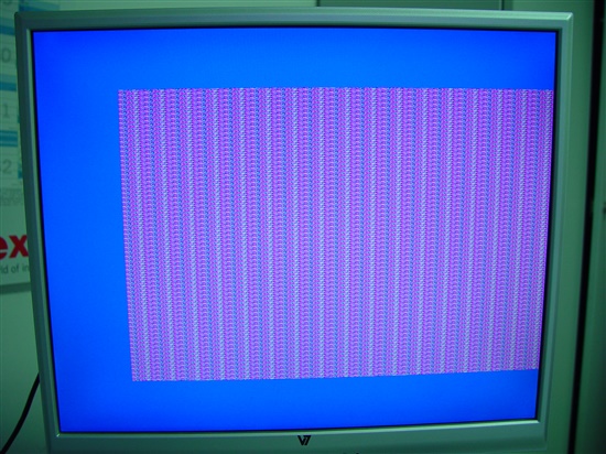

  • HI,
    When you say "setting te background" works, what do you mean?
    When you set the VIDWIN0 size to smaller value (i.e., to D1), are you able to see that the rest of the screen is set to the color that you intended? You can set bkgd color in MODE register.
    Try play with the XL, YL, XP, and YP bit fields, and see whether this corrupted screen can be moved and size-adjusted.
  • Hi Paul,
    you understood my encoded information ... shifting the video window to the right makes the background color (in my case blue) visible.
    What do you think about the SDRAM address register?
    Sebastian
  • let me look into this. I think your register setup is correct, and I will verify it locally.
    Are you able to play with XL, YL, XP, and YP so that you corrupted video appears in the center of the screen w/ blue borders on all 4 sides (background)?
    BTW. Are you using CCS or Linux? It will be much easier to debug if this is in CCS.

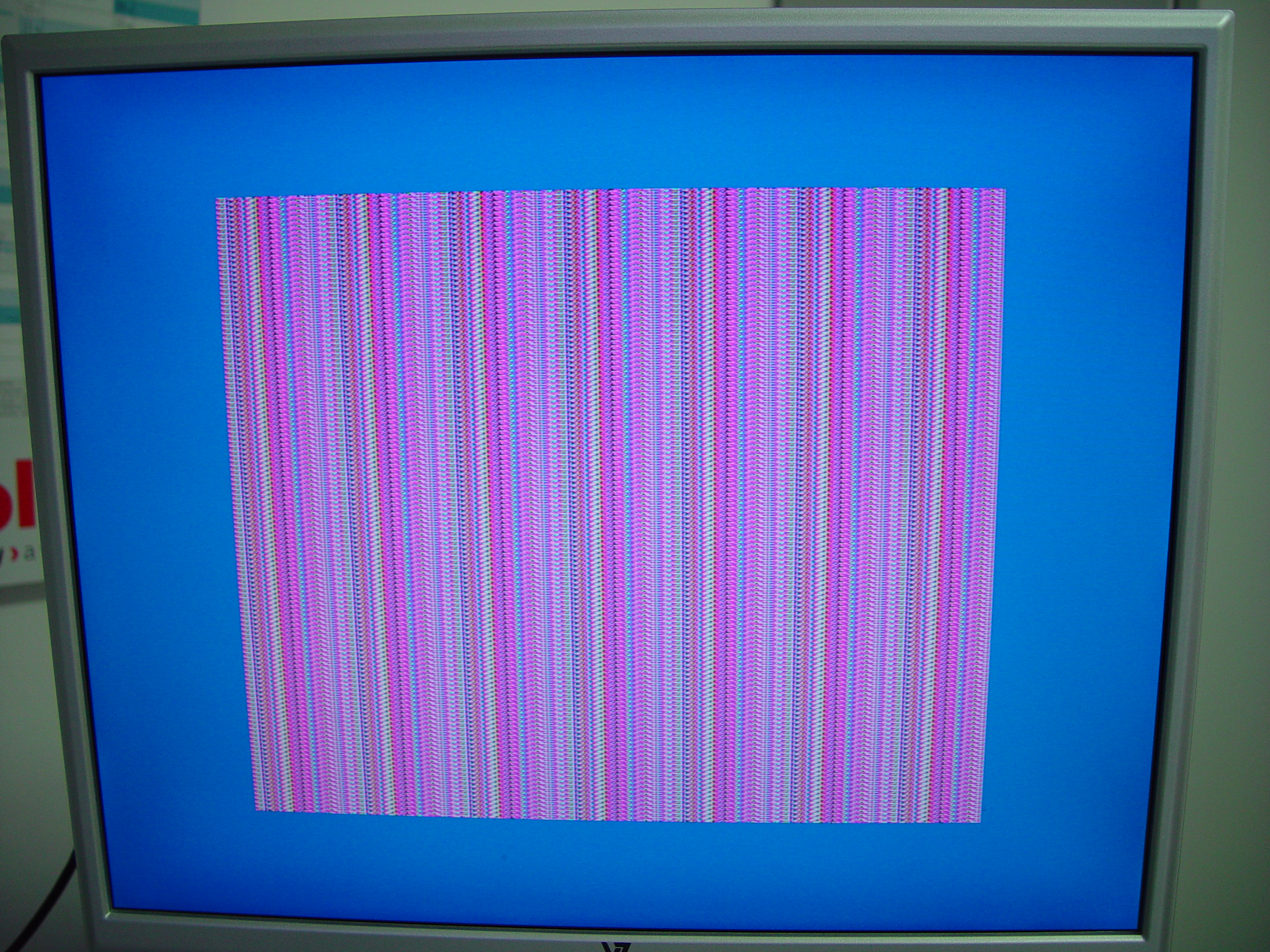

  • Hi Paul,
    thank you for your attention.
    Yes I am able to resize the video window to show four blue borders. But there is something weired going on.
    RESX = 1280, XP = 100, XL = 1280 - 200
    RESY = 720, YP = 100, YL = 720 - 200
    The borders with a width of 100 pixel each do not appear on the right side. The monitor has a resolution of 1280x1024, but the signal is 1280x720. Thus the image should be stretched vertically. But on the image the left border seems to be stretched - horizontally stretched.
    To center the video window, I have to reset the window-y-size
    YL = 1280 - 840 = 440
    Now the picture is centered. The color pattern has changed.

  • Sebastian,
    HSPLS, VSPLS, HINT, HVALID, HSTART, VINT, VVALID, VSTART, HSDLY, VSDLY can be modified to change the display as well (the thing you noticed above is related to these setup). There is not really a fixed formular for this, you might have to try it out until you see a timing that you desire.
    Are you able try your experiment in CCS? It might save your sometime debugging
    It appears that you've enabled OSD, could you please disable and try VIDWIN0 only?
    What I will suggest is you check the value of VIDWINADH, VIDWIN0ADL and VIDWIN0OFST, make sure you are indeed pointing to the buffer you setup. Also, please make sure your input data format matches.
  • Paul,
    I understand that there is no definite definition for the timing register and its no problem for me to make a try and error method.
    Where did you see an enabled OSD? You where right, I wrote some register on the false address. I checked my register address header and found some wrong addresses coming from my old dm355 system.
    The monitor now shows the content of the frame buffer.
    Now I can continue with the VPFE.
    Thank you for your help.
    Sebastian

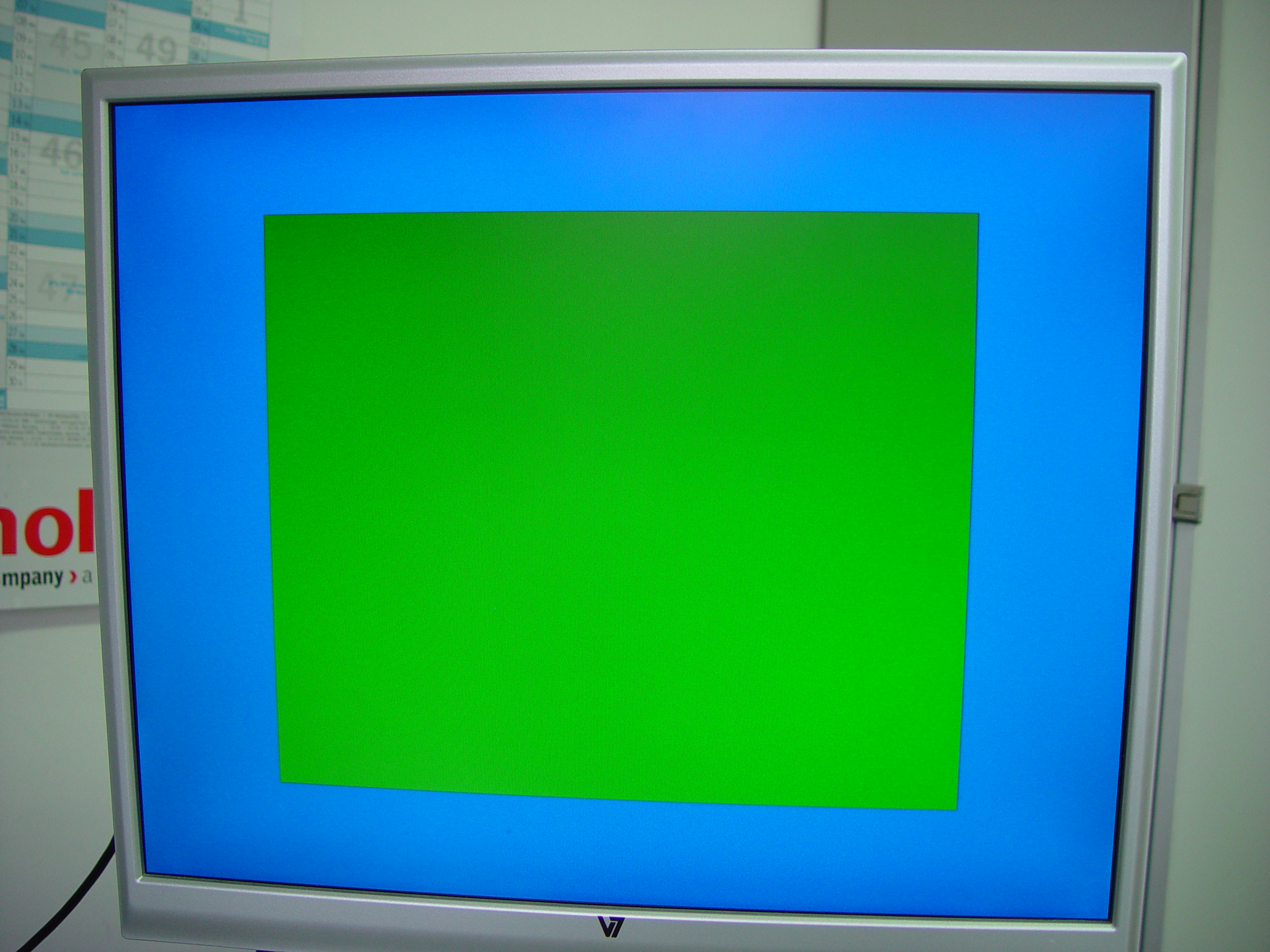

    I am having difficulty in actually getting my picture to display and seeing as you got this running I would like to ask a couple of questions.
    What was wrong with the address that you specified as the buffer address? Did you simply point oto the wrong address?
    I can adjust the window 0 to the size I want to, but my image is not displayed in the window. It is simply some default green screen. Did you load your bitmap "as is" into DDR2 RAM at the VIDWIN0ADR? Or did you do some kind of conversion first?
    The address I load into is 0x80200000.
    Any advice would be appreciated?
