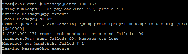

  • Hi Pubesh,
    Pubesh said:
    2. Refer this wiki page, for the support of IPC 3.x MessageQ payload size
    http://processors.wiki.ti.com/index.php/IPC_BenchMarking
    I run MessageQBench test, but the payload size only supports <= 456 Byte. If payload size > 456, it shows error. See the below picture.
    My payload size may be up to 1500 Bytes.  How to resolve it?
    Tony
  • Tony,
    You can take as a reference code from mcsdk based on keystone-I as per below path, this will help you.
    C:\ti\pdk_C6678_1_1_2_6\packages\ti\transport\ipc\examples
    Find more detailed information at this wiki,
    http://processors.wiki.ti.com/index.php/BIOS_MCSDK_2.0_User_Guide#IPC_Benchmarks
