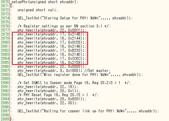

EVMK2E.gel _setupPHY() config
Guru 10570 points
I got EVMK2E.gel file from eInfochips web site.
https://www.einfochips.com/index.php/partnerships/texas-instruments/k2e-evm.html#5-resources
Can I have a question about following code if you have?
_setupPhy() configures PHY #16 and #17 registers several times.
What does it do?
Best regards, RY
  • Sorry, I found it's workaround for 88e151X errata.
    Best regards, RY
  • RY,
    Glad to hear that you have found the reason. In addition that, the EVM having an Ethernet PHY (PHY1 and PHY2) is connected to SoC EMAC0 & 1 to provide a copper interface and routed to a Gigabit RJ-45 connector (LAN1).
    To find more clarity for PHY, see the registers for each module and submodule are described in the chapter-3 at the Gigabit Ethernet (GbE) Switch Subsystem User Guide.
