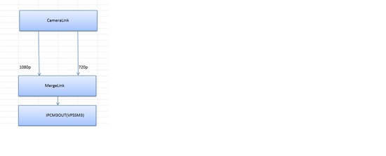

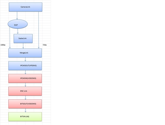

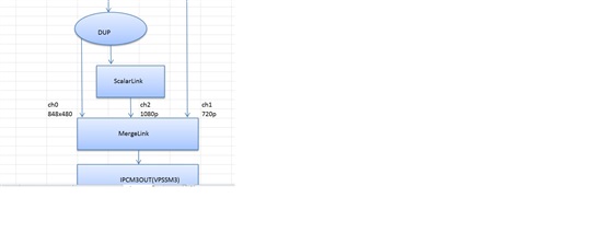

Hi All
I am experiencing problem with the below usecase.
It causes  unhandled  exception  while trying to create the scalar link.
The o/p resolution of the scalar link is 320x192
Can someone check, what is wrong with  this usecase?
Best Regards
JK

  • Hi Anand
    Attached the  use case  code  and  console log
    Best Regards
    JK

            pCameraOutPrm->outQueId = 0;
            /* Second stream */
            pCameraOutPrm = &pCameraInstPrm->outParams[1];
            pCameraOutPrm->dataFormat = SYSTEM_DF_YUV420SP_UV;
            pCameraOutPrm->scEnable = FALSE;
            pCameraOutPrm->scOutWidth = 720;//1920;//1280;//720;
            pCameraOutPrm->scOutHeight = 480;//1080;//720;// 480;
            pCameraOutPrm->standard = SYSTEM_STD_NTSC;//SYSTEM_STD_PAL;
            pCameraOutPrm->outQueId = 1;
            /* 2A config */
            cameraPrm.t2aConfig.n2A_vendor = gUI_mcfw_config.n2A_vendor;
            cameraPrm.t2aConfig.n2A_mode = gUI_mcfw_config.n2A_mode;
        /* vstab Link params */
        vstabPrm.totalFrameWidth  = pCameraInstPrm->sensorOutWidth;
        vstabPrm.totalFrameHeight = pCameraInstPrm->sensorOutHeight;
        glbceSupportPrm.glbceLinkID = glbceId;
    	OSA_printf("JK:gUI_mcfw_config.glbceEnable = %d \n ",gUI_mcfw_config.glbceEnable);//0
        dupPrm.inQueParams.prevLinkId = gVcamModuleContext.cameraId;
        dupPrm.inQueParams.prevLinkQueId = 0;
        dupPrm.numOutQue = 2;
        dupPrm.outQueParams[0].nextLink = mergeId[CAM_STREAM_MERGE_IDX];
        dupPrm.outQueParams[1].nextLink = sclrId;
        dupPrm.notifyNextLink = TRUE;
    	/* Scaler Link Params */
        SclrLink_CreateParams_Init(&sclrPrm);
        sclrPrm.inQueParams.prevLinkId             = dupId;
        sclrPrm.inQueParams.prevLinkQueId          = 0;
        sclrPrm.outQueParams.nextLink          	   = mergeId[CAM_STREAM_MERGE_IDX];
        sclrPrm.tilerEnable                        = FALSE;
        sclrPrm.enableLineSkipSc                   = FALSE;
        sclrPrm.inputFrameRate                     = 30;
        sclrPrm.outputFrameRate                    = 30;
        sclrPrm.scaleMode                          = DEI_SCALE_MODE_ABSOLUTE;
        sclrPrm.outScaleFactor.absoluteResolution.outWidth   = 320;
        sclrPrm.outScaleFactor.absoluteResolution.outHeight  = 192;
        sclrPrm.outDataFormat = VF_YUV420SP_UV;
        sclrPrm.pathId = SCLR_LINK_SEC0_SC3;
    #ifndef MUX
        /* Merge Link params */
        mergePrm[CAM_STREAM_MERGE_IDX].numInQue =  3;
    	mergePrm[CAM_STREAM_MERGE_IDX].inQueParams[0].prevLinkId = dupId;
        mergePrm[CAM_STREAM_MERGE_IDX].inQueParams[0].prevLinkQueId = 0;
        mergePrm[CAM_STREAM_MERGE_IDX].inQueParams[1].prevLinkId = gVcamModuleContext.cameraId;
        mergePrm[CAM_STREAM_MERGE_IDX].inQueParams[1].prevLinkQueId = 1;
        mergePrm[CAM_STREAM_MERGE_IDX].inQueParams[2].prevLinkId = sclrId;
        mergePrm[CAM_STREAM_MERGE_IDX].inQueParams[2].prevLinkQueId = 2;
        mergePrm[CAM_STREAM_MERGE_IDX].outQueParams.nextLink = ipcOutVpssId;//        gVsysModuleContext.swOsdId;
        mergePrm[CAM_STREAM_MERGE_IDX].notifyNextLink = TRUE;
    #else
    	muxPrm.numInQue = 2;
        muxPrm.inQueParams[0].prevLinkId = dupId;
        muxPrm.inQueParams[0].prevLinkQueId = 0;
        muxPrm.inQueParams[1].prevLinkId = gVcamModuleContext.cameraId;
        muxPrm.inQueParams[1].prevLinkQueId = 1;
        muxPrm.outQueParams.nextLink = ipcOutVpssId;
        muxPrm.muxNumOutChan = 1;
        muxPrm.outChMap[0].inQueId = 0;
        muxPrm.outChMap[0].inChNum = 0;
    #endif
    #if 0
        /* SWOSD Link Params */
        swosdPrm.inQueParams.prevLinkId = mergeId[CAM_STREAM_MERGE_IDX];
        swosdPrm.inQueParams.prevLinkQueId = 0;
        swosdPrm.outQueParams.nextLink = ipcOutVpssId;
    #endif
        /* IPC Out VPSS link params */
    #ifdef MUX
        ipcOutVpssPrm.inQueParams.prevLinkId = muxId;//gVsysModuleContext.swOsdId;
    #else
    	ipcOutVpssPrm.inQueParams.prevLinkId = mergeId[CAM_STREAM_MERGE_IDX];
    #endif
        ipcOutVpssPrm.inQueParams.prevLinkQueId = 0;
        ipcOutVpssPrm.numOutQue = 1;
        ipcOutVpssPrm.outQueParams[0].nextLink = ipcInVideoId;
        ipcOutVpssPrm.notifyNextLink = TRUE;
        ipcOutVpssPrm.notifyPrevLink = TRUE;
        ipcOutVpssPrm.noNotifyMode = FALSE;
        /* IPC In VIDEO params */
        ipcInVideoPrm.inQueParams.prevLinkId = ipcOutVpssId;
        ipcInVideoPrm.inQueParams.prevLinkQueId = 0;
        ipcInVideoPrm.numOutQue = 1;
        ipcInVideoPrm.outQueParams[0].nextLink = gVencModuleContext.encId;

  • Hi JK,
    The 'sclrPrm.inQueParams.prevLinkQueId          = 0;' setting is wrong.
    It should be 'sclrPrm.inQueParams.prevLinkQueId          = 1;' since the second output queue of the DUP is connected to the scalar link.
    Even 'mergePrm[CAM_STREAM_MERGE_IDX].inQueParams[2].prevLinkQueId = 2;' is wrong.
    It should be 'mergePrm[CAM_STREAM_MERGE_IDX].inQueParams[2].prevLinkQueId = 0;' since the only output queue of the scalar is connected to the merge link.
    regards,
    Anand
  • Hi Anand
    Thanks for pointing out the mistake. The scalar link is working now. In the same use case I wanted to get  ch0 848x480, ch1 720p and ch2 1080p , all  @30fps.
    (The scalar may not be reqd here, but keeping it because a different resolution may be reqd later)
    But  I am getting only  15 fps  for ch 1. (Second stream of VIP instance)
    See the log below.
    [m3vpss ]  ==================== CameraLink_PrintDetails ====================
     [m3vpss ]  608146: CAMERA: Fields = 27008 (fps = 45, CPU Load = 14)
     [m3vpss ]  608147: CAMERA: Num Resets = 0 (Avg 0 ms per reset)
     [m3vpss ]  =================================================================
     [m3vpss ]  608346: CAMERA: Fields = 2702 (fps = 45), Total Resets = 0 (Avg 0 ms per reset)
     [m3video]  ==================== EncLink_PrintDetails ====================
     [m3video]  613790: HDVICP-ID:0
     [m3video]   totalAcquire2wait in msec:     10809
     [m3video]   totalWait2Isr in msec:    346121
     [m3video]   totalIsr2Done in msec:       939
     [m3video]   totalWait2Done in msec:    347060
     [m3video]   totalDone2Release in msec:         0
     [m3video]   totalAcquire2Release in msec:    362500
     [m3video]   totalAcq2acqDelay in msec:    243195
     [m3video]   totalElapsedTime in msec:    605695
     [m3video]   numAccessCnt:     45426
     [m3video]   IVA-FPS :        75
     [m3video]
     [m3video]  *** ENCODE Statistics ***
     [m3video]
     [m3video]  Elasped Time           : 28 secs
     [m3video]
     [m3video]
     [m3video]  CH  | In Recv In Skip In User  Out Latency
     [m3video]  Num | FPS     FPS     Skip FPS FPS Min / Max
     [m3video]  --------------------------------------------
     [m3video]    0 |      30       0        0 30.82   3 /   8
     [m3video]    1 |      15       0        0 15.39   7 /  10
     [m3video]    2 |      30       0        0 30.82  27 /  34
     [m3video]
     [m3video] Multi Channel Encode Average Submit Batch Size
     [m3video] Max Submit Batch Size : 24
     [m3video] IVAHD_0 Average Batch Size : 1
     [m3video] IVAHD_0 Max achieved Batch Size : 1
     [m3video]  ==============================================================
    How can I get  30fps  for all the 3 channels?
    Best Regards
    JK
    ch0 ch2 ch1
    848x480 1080p 720p

    I removed the scalar and checked the fps.  (Pls  see the use case diag below)
    Now both channels gives ~30fps.
     [m3video]  45723: HDVICP-ID:0
     [m3video]   totalAcquire2wait in msec:       419
     [m3video]   totalWait2Isr in msec:     16571
     [m3video]   totalIsr2Done in msec:        37
     [m3video]   totalWait2Done in msec:     16608
     [m3video]   totalAcquire2Release in msec:     17235
     [m3video]   totalAcq2acqDelay in msec:     12118
     [m3video]   totalElapsedTime in msec:     29353
     [m3video]   numAccessCnt:      1726
     [m3video]   IVA-FPS :        59

    When I add  another channel, the ch1 fps  drops.  Why?
    Best Regards
    JK
  • Hi Anand
    This issue  has been fixed. The reduction in frame rate was due  a bottleneck in the Encoder Link.
    JK
