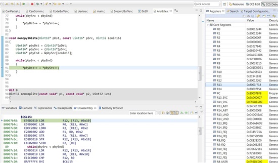

I have a simple function (memcpy16lite()) to copy 16-bit data from Shared RAM to SDRAM.

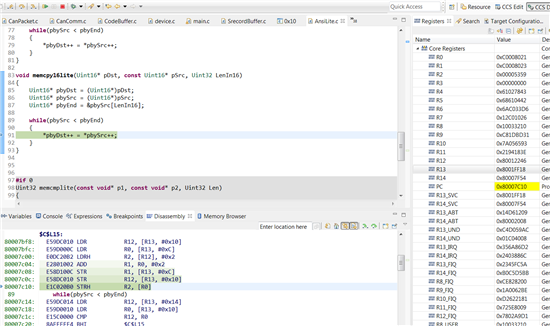

An odd destination address 0xC0008021 was passed into the function. And when the memcpy16lite() starts executing, the entire processor goes headwire...And an assembly-step through discovered that some malicious assemble code has been generated. See the last assembly line "80007c10:   E1C020B0 STRH          R2, [R0]", this line tries to write content of 0xC0008023 to some unknown address stored in R2 (R2's content actually is the data loded from copy source which is supposed to write to 0xC0008021, so the actual operation should be the other-way round).
And as soon as I step through that malicious instruction, the processor goes headwrie.
Processor I am using: OMAPL137 ARM
Compiler: Arm v5.1.5 from CCS6.0

    The problem is not about which memory I access. The problem is about a bad assembly code being generated which try to load some unknown data in the memory as an address to write to.
    Please pay attention to the assembly code generated. It does not correctly perform what the C code intend to perform.

    But still that is a valid point.; ie., checking whether the pointing address is accessible and valid. In your post you have mentioned that an "odd" destination address is passed as a parameter to the function. You have to find out why that address is perceived as odd by you and who calls this function with those odd values in your app code.
    Usually,  the assembly code generated cannot be incorrect. Usually memory related problems will give wierd results.
    Instead of suspecting the converted assembly code, you may have to focus on the address you passed as a source and destination for memory copy. To debug further, split the memory copy 'C' code as multiple lines of operations instead of single line " *pbyDst++ = *pbySrc++  ". For example, as
    *pbyDst = *pbySrc;
    pbyDst++;
    pbySrc++;
    This will give atleast some clarity in your while loop iteration that at what point the memory address becomes invalid.
